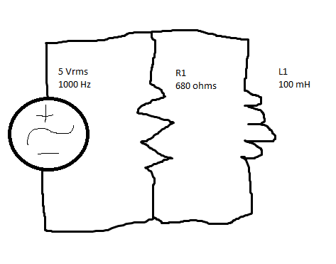

Given: f = 1000 Hz, R = 680 Ω, L = 100 mH, Vrms = 5 V
where you schould put the capacitor ?
in serie with L?
or parralel?
its value depends on where the capacitor is.
for power factor 1 and c in serie with L (if Power factor is 1, you only got ohm resistance)
Zc,l= j(wL-1/wC)=0, now you can calculate the C
first you calculate the Phase Phi with arccos(Power Factor).
Then you need the total Impedanz or Admittance (depends on where you put the C).
Then you can calculate with arctan(Phi)=Imaginary/Real

You don't need an equation, you need an understanding of what PF is. PF correction is the same a making a resonant circuit. Specifically, XL has to equal XC to get a PF of one. Given the inductive reactance, can you come up with a capacitor value to give an equal capacitive reactance at the same frequency?
