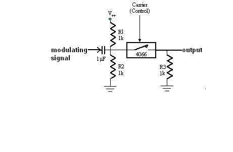

Well, the whole circuit was made of a 4066 Quad Bilateral Switch IC and 3 resistors. when I was not able to see the lower part of the wave then I thought perhaps I lost the lower sideband, although do not know what is lost yet(an envelope?!)?

The problem which epilot has, is that he does not have any tuned circuits after his modulator to reject the base band (audio) signal which appears at the output along with wanted modulated HF signal.

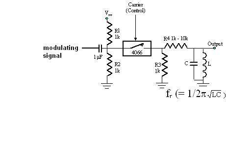

OK, I'll post the current circuit and the tuned section (ie the baseband filter) which want to make today.
The first pic is the circuit which I have and the second is what I want to modify.
You have to select the Q for the filter depending on the bandwidth of your modulating signal.
Know I am reading about Q but it would be very good if you explain more about it.
the modulating signal would be the 20Khz of audio

If you're just wanting to learn about modulation you still need a higher frequency - or only very low modulating frequencies. How about posting the circuit that generated that bizarre waveform?.

Nigel, he did post the schematic yesterday.
