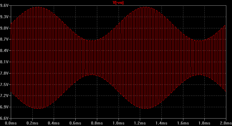

the attachment is a pic of AM modulation by "Ron-H". can you show me the sidebands?
if you call the upper side of the wave "upper sideband) and the lower side of the wave "lower sideband" like you said ""...produce multiple sum and difference frequencies ;;either side of the carrier;;"",so please let me know why I am seeing the upper the lower sidebands the same in freq? it seems the upper and the lower sidbands have the same freq?!
Please, I don't like the math here

AS was mentioned perviously you need a frequency domain plot to understand it - looking at the time domain only confuses things.
No, you can't look at it like that. You cannot see the sidebands in a time domain (oscilloscope) view of the signal.
Like I said before, this is one very tough part of electrical engineering. Unfortunately math is an essential part of the language of electrical engineering. If you can't handle the math, then you must fall back on faith that an AM signal as seen on your scope has sidebands as others explain to you. You may not ever truly understand more than that without the math.

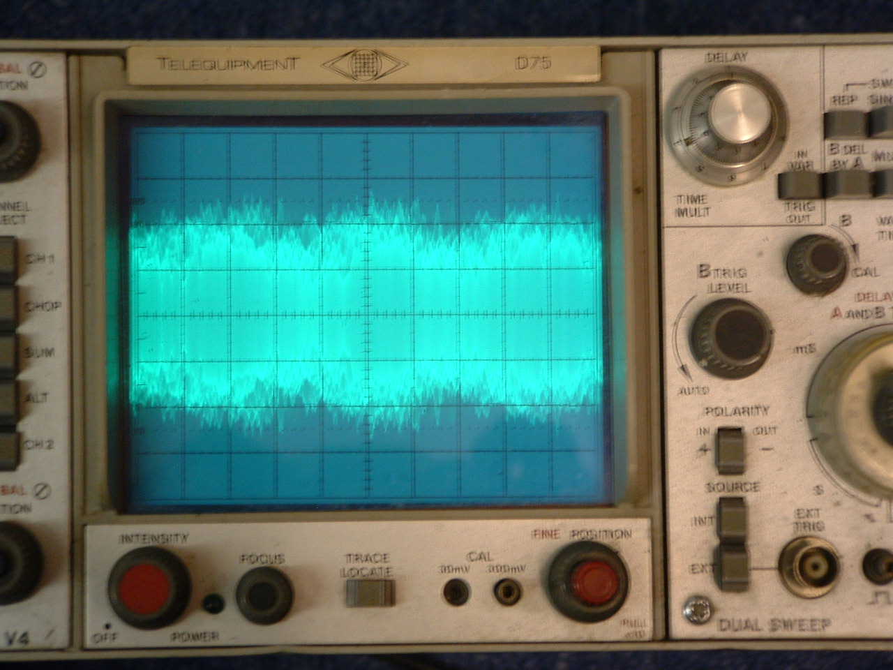

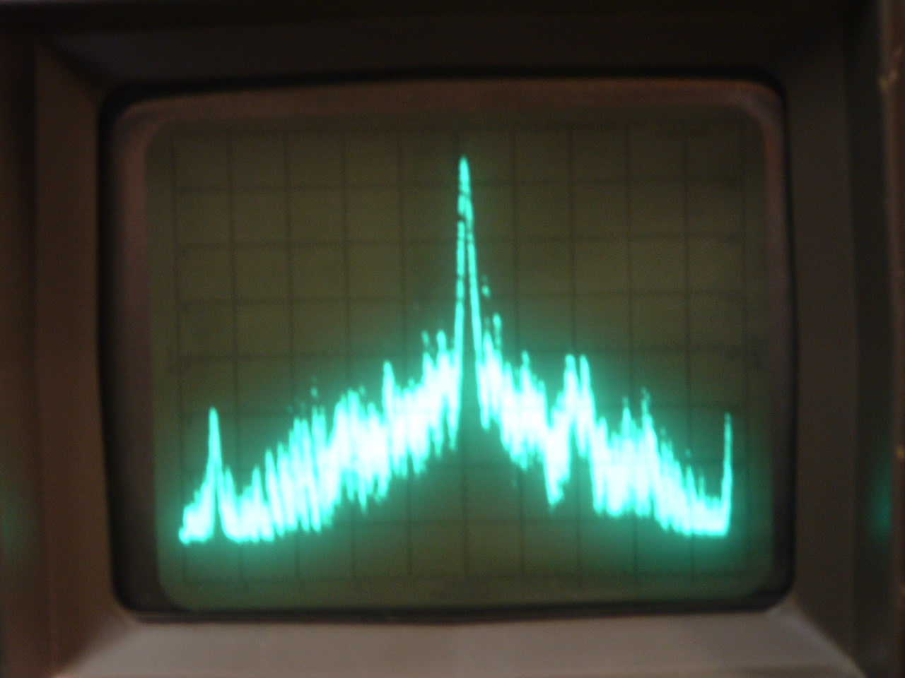

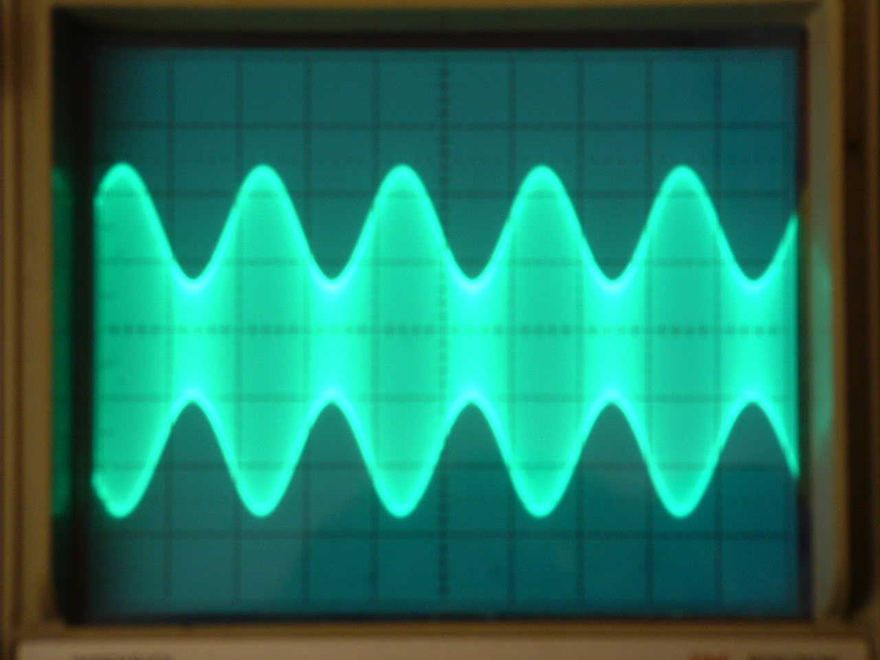

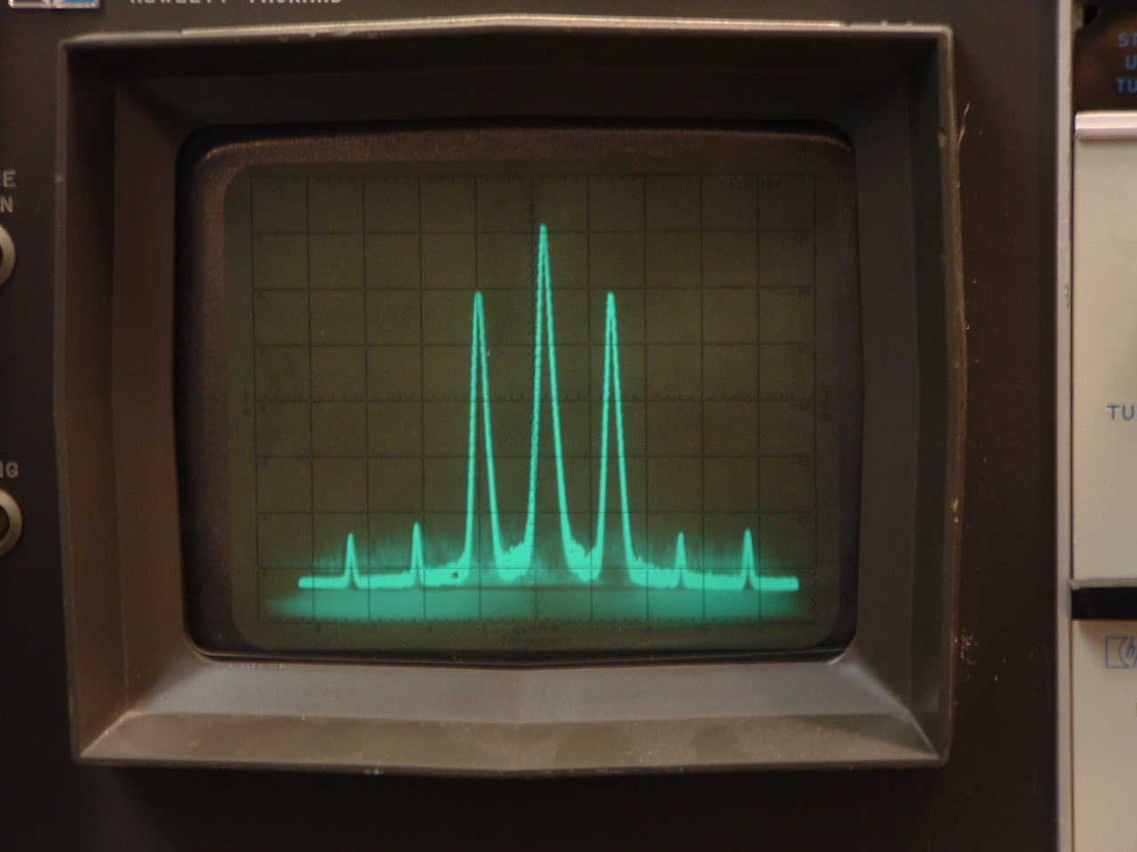

OK lets try a few pictures.

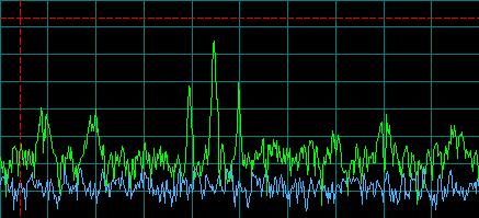

The attachments are photos taken from an oscilloscope and a spectrum analyser.
They are looking at the output from a signal generator which was running at 3 Mhz.
The first two pictures were taken with the sig gen amplitude modulated by a 5kHz tone.
The second two pictures were take with the sig gen amplitude modulated by audio from a radio (speech and music).
On the spectrum analyser, the large centre peak is the carrier, either side of which can be seen the sidebands, upper sideband to the right (higher frequency), lower sideband to the left (lower frequency).
The scaling on the spectrum analyser is:
vertical 10dB per division
horizontal 5kHz per division (calibration is a bit off!).
With the tone on the spectrum analyser, the small blips at each side of the main components are due to distortion in the audio signal and the modulator in the signal generator.
What program are you using to simulate that waveform? Most of them allow you to do FFT and view the frequency output, you can plainly see the sidebands there. A program like LTspice (free) would allow you to do it if yours doesn't.

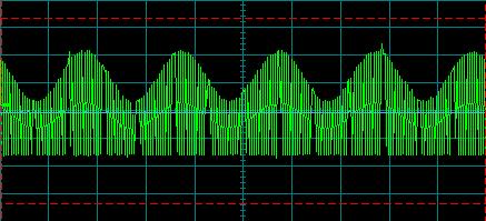

So can someone explain me the below pic?

That waveform can be broken down to AM (carrier plus sidebands), linearly added to the baseband modulating signal. Assuming the modulating signal and the (unmodulated) carrier are both sinusoids with no harmonics, on a spectrum analyzer you would see blips at Fmod, Fcarrier-Fmod, Fcarrier, and Fcarrier+Fmod.

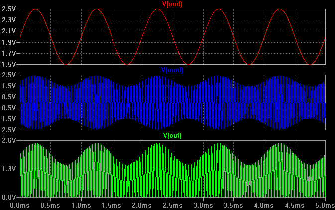

The carrier Is a 40KHz square wave, but the modulating signal is a 1KHz
(sine wave).
I am not able to seed the lower sideband so how are you saying that it is an AM (carrier plus sidebandS)? why not saying SSB plus carrier?!

That picture looks like it was taken from a digital scope, and I think the sampling rate is too low, you seem to have aliases in there.
I am not sure I completely agree with RonH about what is in that trace, my first impression is YUK!.

You can't see the upper sideband either. You can't see the sidebands on a scope, you need a spectrum analyser.
The upper and lower sidebands are not the upper and lower part of the scope trace.

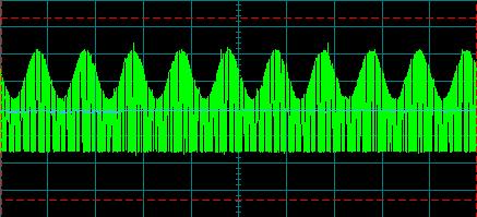

Yes the pic is taken from my digital scope it has a spectrum analyser too and I have seen to FFT of the wave too
the below are the time domin and FFT of the wave at 500uS
Are you sure that the upper level of the wave is not the upper sideband as I have assumed in the papers:?**broken link removed**
Yes, it's NOT the upper sideband, it's just a VERY highly distorted attempt at AM modulation - in fact, it looks like it's been rectified?.

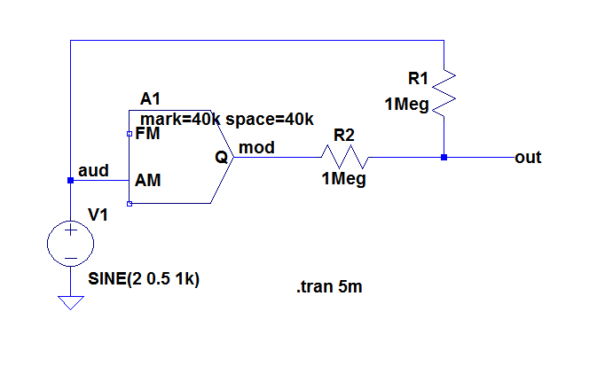

See the schematic and waveforms below.
I can plot the FFT if anyone wants to see it.
