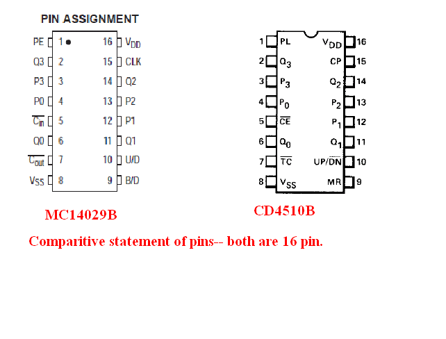

The schematic that you have uploaded indicated 16 pin device for counter. it is pin compatible as CD4029. Please notice that 4510B has only 14 pins.
However, you need to study the Data-sheets and then work out. i suspect the way you have wired an NPN transistor, that you may check and correct.
Alright, I will definately read up on the datasheets, but I got this schematic from another site. They listed it as a 4510. Even when I look up information on it, they all display it as 16 pins in the drawings. Even in Eagle designer. I know it is a 14 pin, but I figured it was only displayed as 16 pin on the schematics and datasheets to make things easier.

I have a moderation
please see the following figure. fortunately both are compatible.
I'm sorry, but what is that comparison showing exactly? IT seems the 4510B in that diagram is 16pin too?
yes jholder82 !
the device datasheet says so. I am attaching the 4510B datasheet for ready reference.
