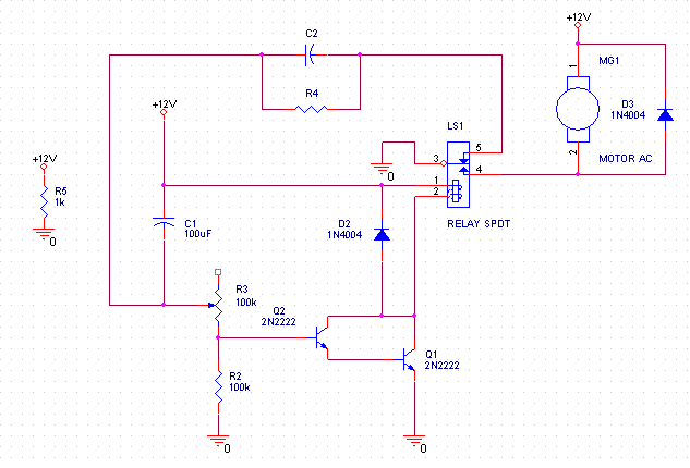

Not THAT robust or it wouldn't... wait, how far is the circuit from the power supply and what kind of wire are you using?
KMoffett - Yes, I thought of those - the Schmitt trigger seems the most likely and that's why I asked about the relay contacts. I'm thinking there might be a way to weasle a cap in there so the relay shifts the charge from the cap.
Say it's an spdt to ground, motor on the NO, on the NC a parallel RC back to the base of the Darlington. Relay drops out, cap yanks charge off the base. Turns off and solidly so.
It might be worth putzing with, but I think I would go with a different delay circuit entirely at this point, since there are so many other options out there.

In the attachment is what I'm thinking. Question is: what would the values of C2 and R4 be to stop the chatter, yet still allow it to turn on? The caps will divide down the initial voltage for the base, but if c2 was, say, 47µf, that would still give us 8V to drive the resistor network to the base... relay kicks it, C2 discharges through R4, C1 discharges through R2 and C1. R4 needs to always discharge faster, so make R2 = 220k.
Transistor sails on wobbly legs through the linear sea to the shore of can't-quite-manage-the-relay current. Relay cuts out, motor cuts out, C2 cuts in. The dischargesd C2 immediately subtracts a third of the charge from C1, and the circuit stays off in spite of the boost of 2V from Vcc without the motor load.
Make sense?

Hello all, I am new here so be kind... :)
I have a need for a VERY simple timer circuit but can not find a diagram anywhere.
I need a circuit that I can supply 12vdc @ 1amp, and it would output the same via a relay to a small motor for 5 - 15 seconds and then stop. Can anyone help me with a diagram.
Thank you.

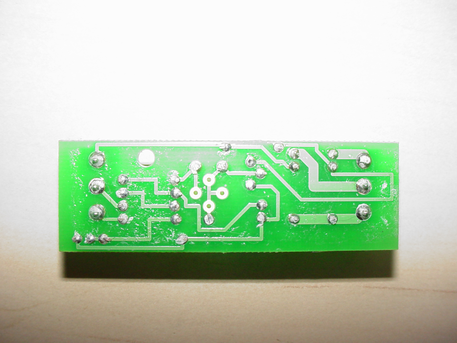

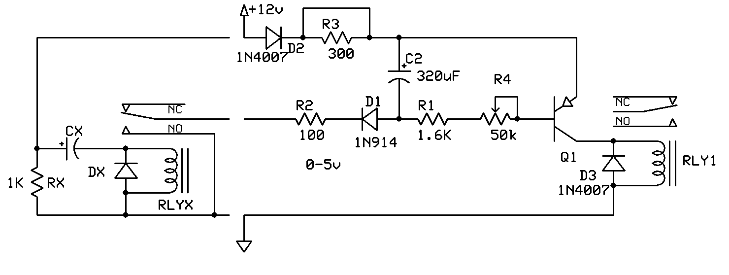

The circuit will have a 12v source @2amps, The time it needs to get to ground should be fast, the time it stays at ground should be short. The Diagram for the main device is Here (traced out the device, so it may not be 100% accurate) The trigger is what I need to get around. I paid like $25 for this crappy little thing I would like to make use of it.. :)
I redrew your circuit...and it won't work the way it's drawn. Do you have a link to where you purchesed it? It looks like its supposed to be a time delay relay, triggered by a brief ground on the input. Is your input trigger supposed to be +5V>GND>+5V (your symbol) or just OPEN>GND>Open at power-up?
Ken
Ken
OPEN>GND>Open
The Item came from canada, and was bought on ebay. I can take some Hi res photos from the bottom if that would help.
Update: Left side is input from top down its -v trigger +v
Can you add a component side shot? Did it come with any kind of documentation?
The circuit you drew would be OK if the transistor were an PNP instead of the 2N5088, a NPN. It's somewhat similar the circuit that duffy posted, early on.
Because the trigger input needs to rapidly charge the capacitor C2 and then open, the easiest way would be another relay arranged as a monostable. The timing would depend on CX and the relay coil resistance.

The coil is 400Ω However I can not use a resister across +v and -v as the source is 2amps and would burn up anything I had, plus it will limit current to the motor. (it needs as much power as can be delivered.)
What I may do it get an automotive relay, and just hook it directly to power at startup and the trigger to nc just like above. It may do the same thing and not burn up.
