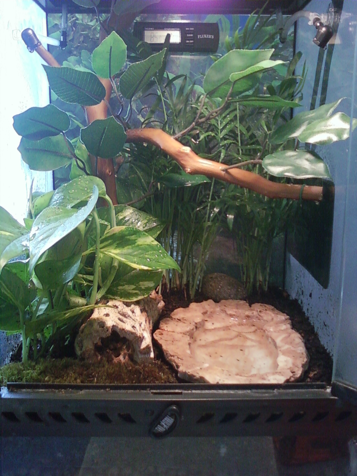

That is correct, the +v will be connected to circuit and a pump. The relay on its 'NO' side will switch the ground, which is attached to -v of the pump.
Very cool! Hope the frog appreciates the effort. Can you water the terrarium without misting up the glass and obscuring the view?
the misting jets I use, are more like foggers. I have a fan in the front of the terrarium blowing down which helps keep the front from fogging. I'll attach an image.
Its actually a universal water pump for the sprayer in your car, its connected to a water tank, to keep a terrarium watered. I have live plants and tropical geckos and a frog.

Oh man is this weird - a guy at work was showing me that exact temperature and humidity gauge not three hours ago.
