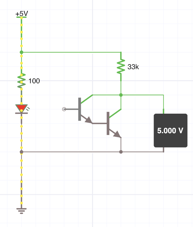

Need a simple circuit,idea to test speed of small motors,such as cassette,8 track,turntable motors.
Doug
I know of hall sensors,photo sensors.anyone have a circuit that work well?I have oscilloscope and pulse ,frequency counters.
Doug
Since you don't know how many windings are in your brushed motor, a scope isn't great help so you'll have to add something to the shaft like a rotary encoder. Or even a piece of white tape with a wide black line on it (parallel with shaft. Then illuminate the tape with IR and use a photo resistor to see the voltage drop each time the black line passes.

Point the IR LED at the shaft w/black line and point the base (lens) of a photo-Darlington transistor at the illuminated shaft. Measure frequency where the meter is attached.

Make yourself a 60 segment optical disk and put photo-interrupter across it. Then you can use your frequency counter in Hz to read the speed directly in RPM from the photo-interrupter output (ie 1 rev per second = 60rpm)
(I did this to test a lot of small motors recently, worked very well)
