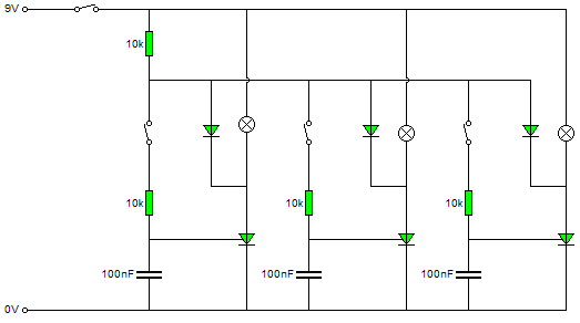

The circuit provides ground only to load selected first. Load that is driven desprives all others of triggering voltage to any number of load. The supply voltage is up to 50v and load current around 50mA
Rubbish!
How?
Please annotate your schematc and show us how it works.
The gates are all connected to +V via the bulbs ao they will burn out.
The switches are all connected in series with the cathodes.
The anodes are all connected to +V via 1k.
There is a circuit very similar to this that works. My guess is you've tried to draw it but got it wrong.

The circuit is a simple relaxation type oscillator . The Programmable Unijuntion Transistor (PUT) in a blocking state conducts. When its gate is made negative relative to its anode. This task of switching is accomplished by the resistor 1K.
You're still wrong.
Those symbols aren't programmable unijunction transistors, they're thyristors/SCRs!
Even if you replaced them with programmable unijunction transistors, it still wouldn't work as a relaxation ocsillator since there are no timing capacitors which are required in all relaxation oscillators!

which circuit did you build? the PUT one that muki posted? that one will never work.
use the one from the first page. I think the reset mod I suggested will work fine.
Geez, I haven't seen a PUT for over 30 years.
Muki got the symbol correct, but his circuit won't work.
A PUT works as an oscillator by having the charging capacitor at its Anode, making a trigger voltage reference with a voltage divider at its Gate, and having the load to ground at its Kathode (spelling mistake because it is K).
When the capacitor's charging voltage at the Anode is a little higher than the gate voltage then the PUT conducts the capacitor's charge into the load.

You're right, after logging off I looked it up on the Internet and understand PUTs now. In a way, a PUT is like an SCR but it triggers when the gate is above the anode instead of below the cathode voltage.
In theory you can make a priority quiz indicator with PUTs and I know this isn't the way to do it, but I don't see why anyone would bother when SCRs are so much easier to get hold off.

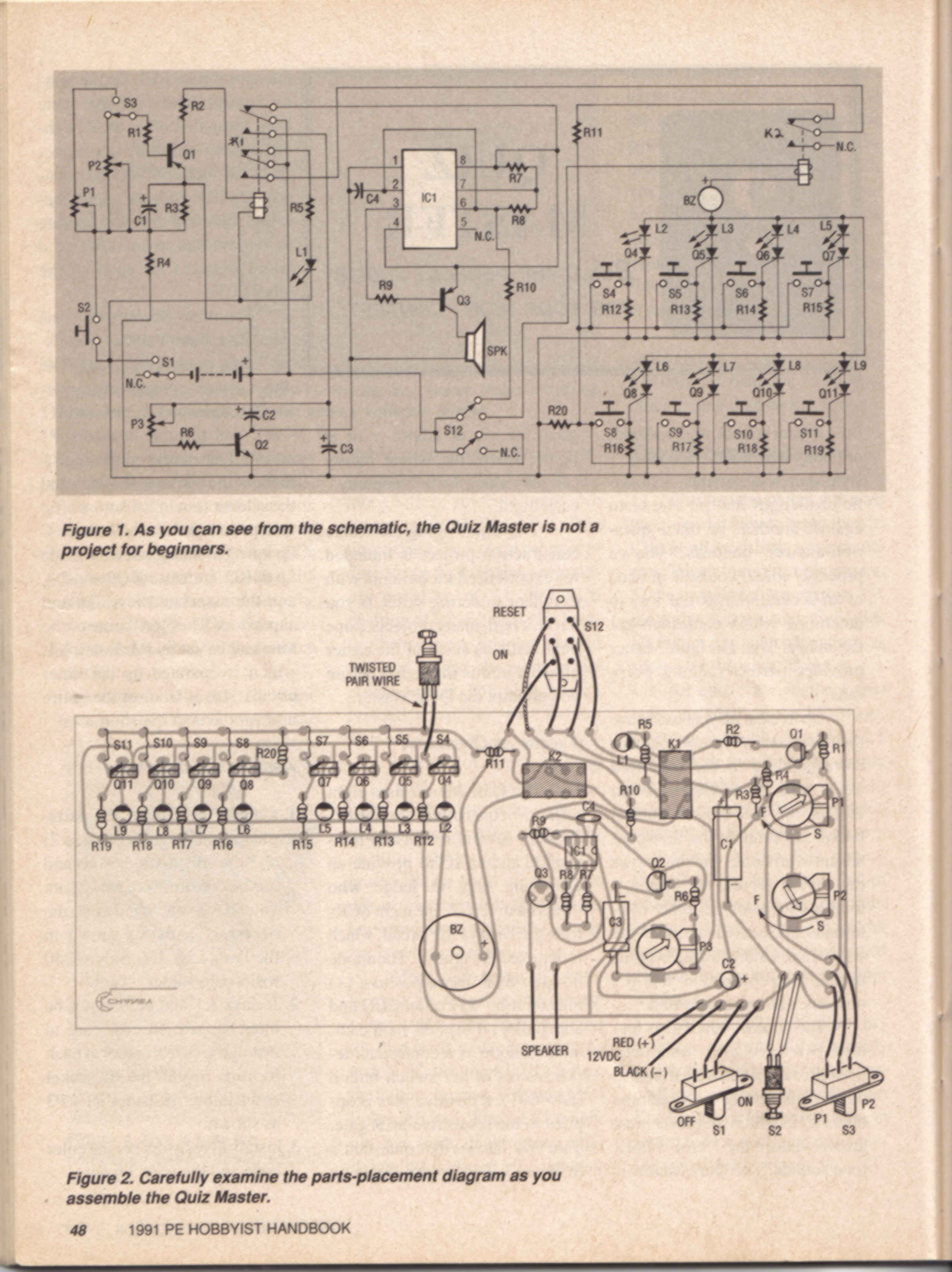

musthave said:
here is a quiz master from 1991 PE hobbyist handbook
Good, but a schematic is useless without a bill of materials.
