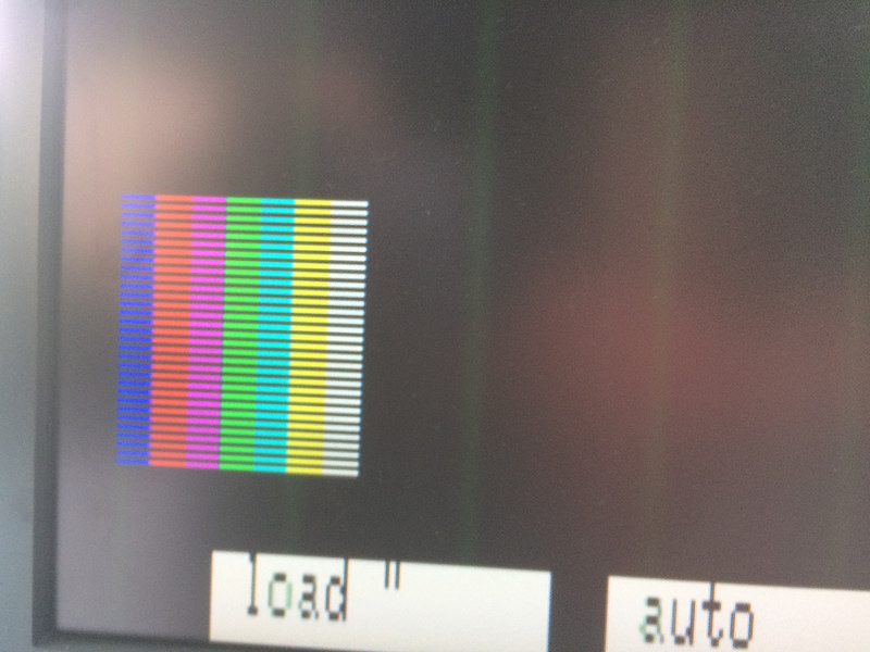

I ned help ,my machine uses an RGB 8 pin monitor plug and I need to convert to an vga. My monitor is going out of clarity and I can't see the image real well. It uses an PC-8091K cable

Edit - looked up the NEC info, and a bit of searching shows that it's almost VGA compatible, signal-wise.
Info here (use google translate):
8 pin DIN connector layout shown here:
It's pretty much pin-to-pin by name for the VGA signals, but with 150 Ohm resistors added in series with the RGB lines to reduce the signal levels.
You mention clarity,,, Is this a CRT monitor and have you checked for a focus adjustment. If the monitor is "well used" then maybe you could increase heater supply voltage with a step up transformer or take one heater wire and wrap around flyback core to increase voltage.
