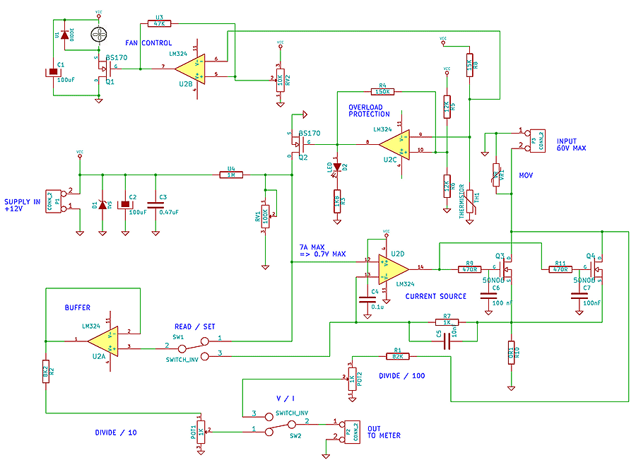

As a complete novice I'm currently in the business of equipment aquisition to compliment my new found knowledge ! Well, knowledge ? I've already found it's easier to collect the gear than to the knowledge to know when and how to use it but I'm getting along OK, mainly thanks to you guys !
I have a 'Scope, a Freq. Gen, a Freq. Meter, several Multimeters and a Component Tester, all the usual handtools and a soldering station. I'm currently building a PSU with a variable 0 - 30v @ 3amps and 5v & 12v discreets which is a project I've developed with considerable help to get to the building stage.
My next equipment project is a Variable Constant Load and I'd like your opinion of the scheme detailed below. There are some elements I have already concluded to change related to how the unit is powered but there are some elements of the construction I don't yet understand so I'm unable to access the viability ie I thought a Varistor made good coffee at Costa ?
The link to the website page is **broken link removed**
and the schematic is posted.
Thanks Guys

I'd be a bit suspicious of the 2 paralleled mosfets. They may well balance out the load as their Igs changes due to heating, but every fibre of my being screams out to put in balancing resistors. These two will give you a combined max current capability of 100A if the transistors stay cool, however once they heat up that capacity will go down - the datasheet says 35A at 100C, so that would be 70A combined. Personally I think I'd just use one tranny and build a much "lighter" load.
I'd also question that 0.1R sense resistor. You need to make sure it is up to the current this thing can handle. Same goes for the wiring and panel sockets, it all looks a bit lightweight, so (and someone please correct me!) what's the point of a 100A pass element when the wires connecting it are going to melt?

Thanks for your information, much appreciated. I will need to read through and think about what you've said a number of times before it totally makes sense to me - dementia, you know - however, I did recall reading on the webpage .. ..
'In this design, the maximum current should be about 7A and it is limited by the 5W resistor I used; not by the MOSFETs. Larger currents can be achieved with a resistor capable of 10 or 20 W dissipation (which I didn't have handy). The input voltage should not exceed 60V (maximum VDS for these MOSFETs). As an added protection measure, I added a power MOV from the input to ground to protect the MOSFETs against high-voltage transients.'
At the moment I'm not sure if this is answering your concerns or not but to add to concern, I'm not sure I want to build something capable of 100A for m y own safety. May well be safe in experienced hands but, meanwhile fried MM ?

I never noticed that, and didn't think of it for myself either - shame on me! I hadn't actually read much of the text, and wrongly assumed the paralleled mosfets were to increase current capability, when in fact they are to decrease the combined "on" resistance. Oops... With a 0.1 ohm sense resistor it would need a rating of 1000W to be able to pass 100A. Well that's never going to happen. I am a dumass...
Anyway, no need to worry about safety aspect of something capable of handling a large current, apart from its ability to get hot. It's not the excessive ability of a device to cope with extremes you have to worry about, it's the extremes themselves, and inadequately rated components.
Ok, quick calculation. The article talks about 7 amps because the 0.1 ohm resistor is rated at 5W, so I'll use that. The mosfet in use has an Rds(on) of 0.022 ohms. So with 2 in parallel, that's 0.011, put 7 amps through that, you get 7x0.011=0.077 volts. With only 1 transistor, you get 7x0.022=0.154 volts, and only 1.078 watts of power dissipation (and only 0.539 for the 2 transistors in parallel). So the question becomes, under what circumstances are you going to want to load something where the voltage is that low? The only thing I can think of is foldback current limiting of a PSU - ok so it might be handy if you design psu's... But even so, you have to remember there is a 0.1 ohm resistor in series anyway, which at 7 amps is going to drop 0.7 volts, effectively swamping the voltage dropped by the mosfets.
Supposing you want to test a 12 volt PSU, rated at 3.5amps, with a 3 amp load. That gives you 36 watts which your load has to dissipate, and it has to set it's mosfets to have a resistance of 4 ohms (well ok, 3.9 because you have the sense resistor in series) - way above the low combined Rds(on) you get with this design. But suppose you crank the load so it now draws 4 amps. If the PSU has foldback current limiting, the voltage will drop right down, and depending the design it may sustain that amount of current or it may pop a fuse, but what should happen is that the voltage drops down enough that the constant current load reaches it's minimum resistance, so only 3.5 amps is delivered. Foldback is conceived with the idea of constant resistance loads, where if the voltage is dropped down, at some point the current will fall within the design limit of the supply.

As for the safety aspects, whilst I appreciate that for the Constant Load the only real issue is heat dissipation it does also mean that it is connected to something capable of supplying 100 amps. I don't think I want something that powerful on my bench.
The calculations are great information and amazingly I understand them and also the likely outcome of the circuit in use as a result.
My next step is a twofold I think. Firstly, I'd like to play around with the calculations with different values so that the analysis procedure sticks with me and secondly, I clearly need to do more research into Mosfets, balancing resistors etc
When I've done that, I'll have a go at revising the schematic and perhaps I could then seek your further thoughts

If you have a 20W sense resistor, you would get a max current of 14.14A, more than enough for most people. The resistor would be dropping 2V, if you had a single mosfet it would be dropping 0.3V and dissipating 4.3W. So anyway, the resistor would need a lot more cooling than the transistor.
I did a quick search for constant current loads and found this: https://electronicdesign.com/displays/resistive-dummy-load-draws-constant-current-12-50-v it's worth a look to compare the design. Personally I think this one is much better, though you don't have the fancy extras. You could change the mosfet for the one used in Paulo's design though.
