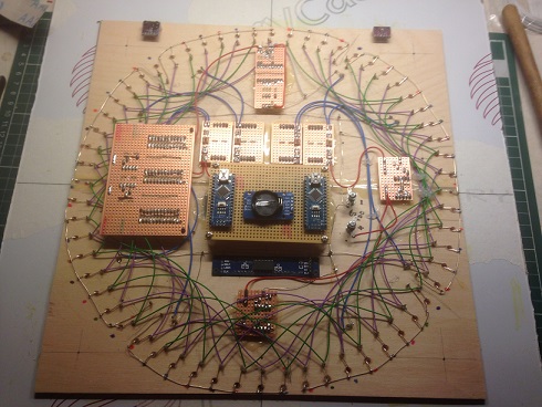

This got me to the point that a structure could be made up and here it is .. .. .

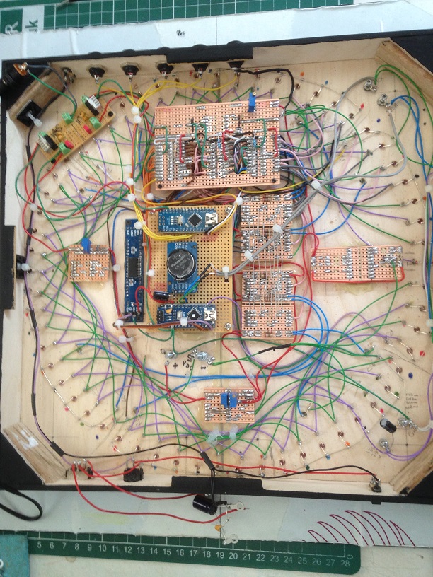

The white border is the protective coating on the back of a 40 cm square sheet of Gloss Black Acrylic with a piece of 4mm plywood, glued and screwed in place; The Stripboard on the LHS has 3 x MAX 7219's soldered in place and the pair of sensors are in view on the top edge. The two 'posts' visible to the right of the Nano's are M3 allthread with nuts & washers which provide +ve & -ve power for the whole unit.
Having completed all the circuitry, I added 30mm plywood upstands to all 4 sides which held a piece of Matt Black Acrylic as a cover.
In this view, the 5 buttons in place for adjusting Time & Date are clearly visible, as is a small additional power board holding 2 x 7805 V. Regs;
At the bottom of the picture is a pair of capacitors which had straddled the M3 power posts but I had laid them aside in favour of the V. Regs for a particular reason.
From the outset the code operating the DS 3231 had run perfectly without any issue; however, that was not the case for the sensors code. The code took a reading from each of the Sensors, transmitted to the Nano via i2C which was then converted for display on a proprietary 8 digit 7 Seg Module. This all worked perfectly for a period but then the display would freeze and only a power reboot would reinstate it.
I spent 3 weeks, coating the circuit with noise abatement capacitors; using screened cable to protect signal wires from stray capacitance; the small circuit board with the V. Regs was to separate the power supply to each Nano which also offered no improvement. A huge investigation got underway, by me and by some of my ETO friends but no solution emerged and whilst the Clock continued to 'tick', the sensors ran or didn't run without any influence from me.
I had returned to the datasheets a number of times looking for inspiration without anything obliging; A part of the sensors 'Setup' code includes a series of parameters relating to sampling, over-sampling, averaging etc., which I had deliberately taken at face value for fear of getting into my inexperience too deeply;
However, the BMP280 datasheet explains that when a sample is taken it is in two parts - the time taken to collect a sample, which will vary slightly according to it's value - and a 'standby time' which is the time dormant between samples, which is set by default at 8ms;
I changed the 'standby time' to 100ms and the sensor circuit ran much longer before freezing . . .
I concluded that because the sensor readings are coded to display as a scroll with 15 seconds display and then 2 seconds interval, if the 'standby time' and the 2 second interval coincided there would not be any signal to 'wake' the display; In an attempt to prove this, I extended the interval to 10 seconds and the display froze after one cycle.
A quick maths exercise ( not my strongest discipline ) display of 15 seconds + an interval of 2 seconds = 17 seconds; of the options available for 'standby time' I selected 4000ms because 17 / 4 doesn't work .. .. .. .. .
The Sensors circuit is now perfect too ! Eureka !!

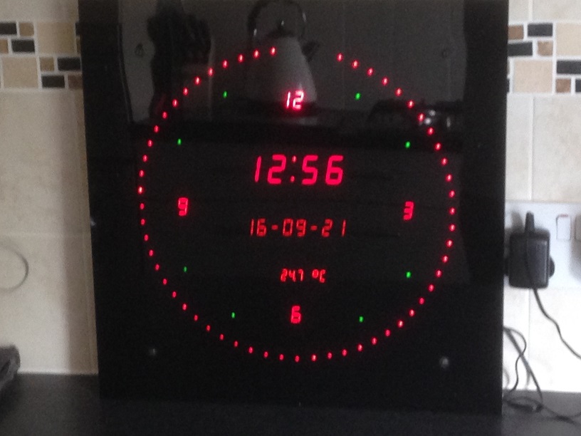

Here is the almost finished article - there are a few aesthetic items to add .. ..
