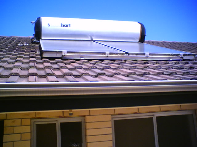

Hiya Again Guy's,
Well the bargin's keep coming my way it seems :D . Tomorrow morning I'm going to pickup the solar hot water in the picture link below. It's only costing me $200 Oz and there is a leak somewhere in the tank so with my skills I can easily fix any leak I find. Now this system was used as a mains water pressure system but i'll be changing it to a gravity fed open system. The Current hotwater service I'm using is an instant gas hotwater system and I'm using 1 45 kg of gas every month which now costs over $100 a bottle. So with my solar hot water system and the extra battery power not only will I be cutting down on monthly gas expenses but having the extra solar and battery power as we're in for a long hot summer I'm going to see the daiken bloke about a 2hp cooling inverter aircon so my family can stay cool thru the day when I'm at work but also when I get home it will be nice to have a cool house to have my after work beer :rolleyes: .
Cheers Bryan :D
