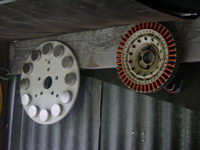

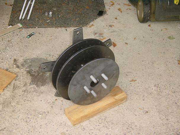

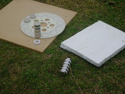

Here is my magnet plates and stator mounting bracket all lazer cut.
And my mill without mags or stator

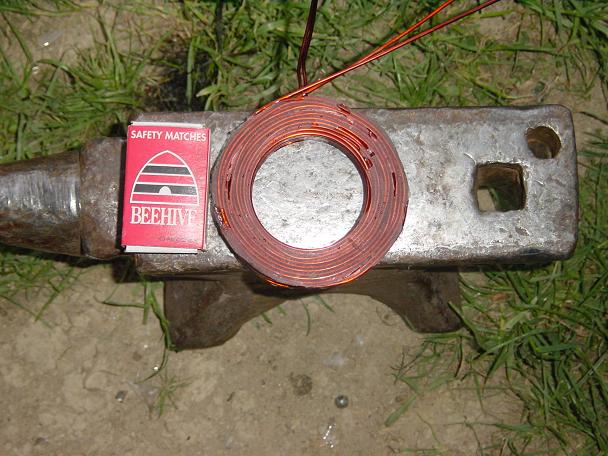

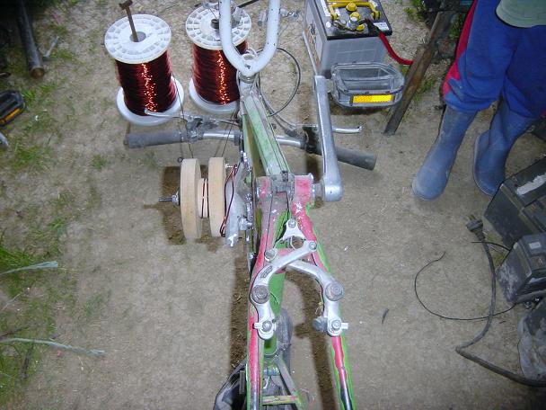

my coil winder
and one finished coil
Am sending magnet plates for powder coating.

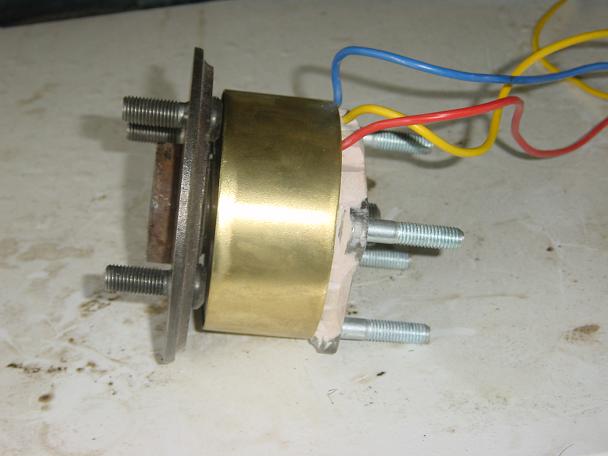

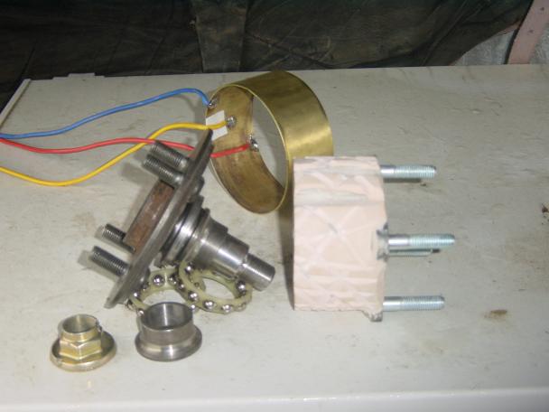

here some pictures of my sliprings homemade around a rear hub on a frontweel drive car some just bolt on this will turn my mill into the wind.
now all that needs doing is using the ring for a dam to pour resin in then cut/seperate them and add my carbon brushes.

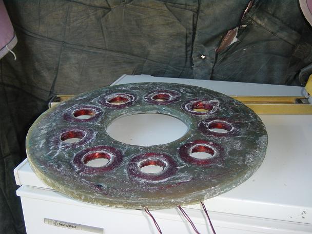

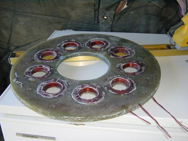

Here is my stattor mold almost ready to pour the blue stuff in one coil is wax when finished I can remove this and the hole left might help with cooling.
Hi Shawn,
Im still waiting for my 1 cent royality per ring for the slip ring design.:D
Pete.
