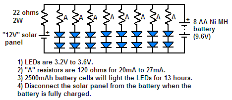

solar cell cathode ---> resistor (to take 12V down to whatever)---> batteries connected how?(series, parallel?) ---> batteires connected to 6 pairs of LED's, each pair connected in series, the 6 pairs connected together from the battery in parallel ---> anodes of the 6 LED pairs connected to ?????
I'm going to try to draw this up on paper to see if htat helps me.

The LEDs have a max voltage of 3.6V so 3 in series need more than the battery can supply. Two in series is a max voltage of 7.2V and a current-limiting resistor of 120 ohms will allow a current of 20mA.
That is one string with two LEDs in series and in series with a resistor.
Connect a few strings in parallel across the battery.
That's how I see it going together... But I'm PROBABLY wrong... how wrong am I? Can anyone edit this with paint or something to fix it up?
Your battery is connected as 2.4V.
It is in series with the LEDs which are connected as 7.2V.
They are all in series with a current-limiting resistor.
They are all in series with the solar panel.
The LEDs will glow only when the sun is shining on the solar panel and the battery will never power the LEDs.
You need two LEDs in series and in series with a current-limiting resistor. Make a few strings like that.i They are connected to the battery which is 8 cells in series so they make 9.6V.
Then a charger circuit connects between the solar panel and the battery.

I'm sorry to ask someone for so much work, so I don't know if anyone would do it but... Could someone take the picture that is below, copy it to a simple program like Paint, and crudely fill in the blanks along my circuit so that it will work properly? I know there wil be resistors, but I'm not sure where, and in this scenario, I upped the number of batteries to 3x 3x1.2v in series in this schematic, making 3.6v series which the ebay page says the LED can handle, but I guess it's up to you guys if you edit this image to add another resistor :confused: . Anywyas, if you DO export to paint to help me out, I can't thank you enough... If you just want to describe what would go where, I still can't thank you enough for your patience you have shown so far. Thanks to all!
If you use a solar panel that is designed to charge a 13.8V battery then you shouldn't use a battery of only 3.6V.
The battery voltage drops a little as it is discharged. The LED voltage could be 3.2V or 3.6V or anything in between. You need to have some extra voltage to allow for the changes.
Make it like this:

Ok, I understadn how to wire it that way... The diagram makes sense to me and all, and I shouldn't haev a problem following that BUT... Is there a smal circuit I can purchase to insert in the setup that will automatically stop cahrging hte battery when it is fully charged? Either that or switch the light on automatically when it's dark? If so, where in the line would it go?
See, I can trust your word and build that circuit, but to ME when I read that diagram, I think that what the solar panel is doing (because it's connected to all the LED's before the battery) is that it's turnign hte LED's on AND charging hte battery a tthe same time... I don't doubt you at all, but with my limited experience with circuits, that's what I see that circuit doing... Could you explain to me what it is REEALLY doing? Thanks! :)
BTW: I'm on my way now to pick up a 1.5 W, 12V "trickle charger" from princess auto. From waht the lady said on the phone, it sounds EXACTLY like the one at Canadian Tire, except she quoted 1.5W... But comes with the same stuff as the canadian tire one so.... We'll see :)
Hi Mike,
You are correct. My circuit has the solar panel lighting the LEDs then the battery doesn't get charged.
It needs to have another circuit to turn off the LEDs during the day when the battery is charging and turn on the LEDs when it is dark. Use a switch.
It needs another circuit that is an automatic battery charger that stops the charging when the battery is fully charged. Use another switch to disconnect the solar panel when the battery becomes warm from being fully charged.
