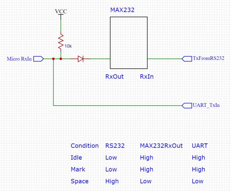

My primary interest is in UART interfaces at the moment, but it seems a shame not to include RS232 as an option. What I'd like to do is populate the board with a MAX232 chip (which supports 2 Tx/Rx interfaces) or two, with the idea that either the UART connection OR the RS232 connection will be used.
The transmit lines from the USB/UART chip aren't a problem. The MAX232 chip in parallel with the UART connection won't impact anything. The complication is with the receive lines. If the MAX232 chip has no signal, it's going to hold the RxOut line high, so an active UART connection would fight with that.
I think the following sketch solves the problem without the need for jumpers or other interventions. The diode will allow the MAX232 chip to pull the line low (1N4148, or maybe a shottky?) and the resistor pulls it high otherwise. Have I got the logic straight on this?
I'm confused, are your devices TTL level non inverted RS232? Your problem is going to be from the MAX232 ttl out to the USB chip, this will be low when idle so if in your diagram Micro RxIn is the USB chip then I think that will work. I'm not sure if you'll need a pullup on the MAX232 input.
At present, my devices are all TTL-level UARTs, but that's not to say that at some point I won't want to include a RS-232 device. One example would be my Fluke 45 bench DVM.
Might prove useful: https://www.sparkfun.com/tutorials/215
Note the "Inverted" for TTL.
besides that, your dealing with >=3V and <=-3V for RS232. The original spects were +-25V excursions were allowed. Cheap RS232 used +-5V levels. I think the MAX 232 uses +-10V levels. The switching point is still + and - 3 volts with -3 to 3V being undetermined.

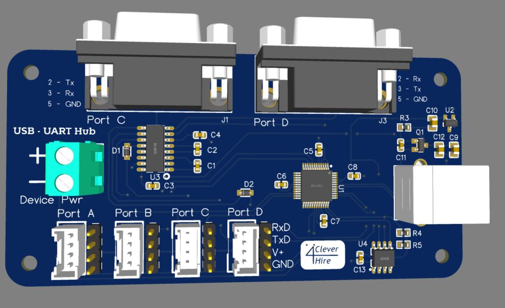

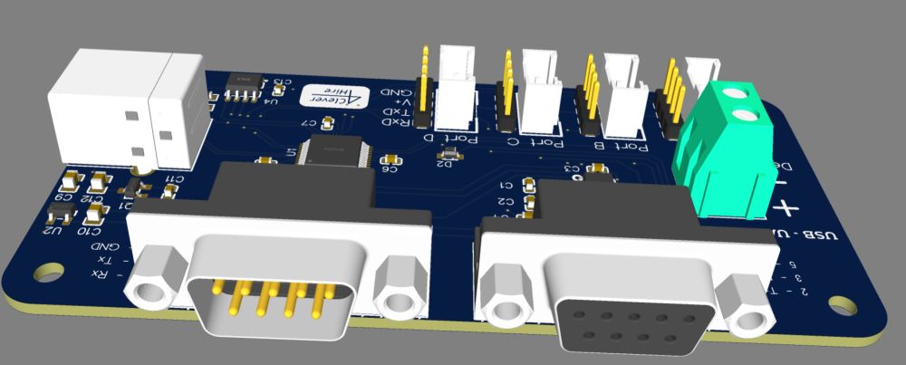

I've laid out a board using the EXAR chip I linked above. One USB connection will provide four UART serial interfaces. Along the bottom edge of the board are four 0.1" headers for Dupont connectors and 4 "Grove" connectors used by Seeed Studios and Elecrow (called "Crowtail"). My thought is that one or the other style will be installed as convenient for the application.
I've included a MAX232 chip to provide true RS232 interfacing on 2 of the UART channels. The cost to add this option is minor, and as I see this being used to interface instrumentation, the option is useful.
I used USB power for the interface, but I didn't power power to the UART connectors. In my use case, the devices are powered and I didn't want to worry about USB power limitations. There is a terminal block for supplying power to the UART devices if needed.

Darn it. LCSC has stock of the USB chip. JLC does not. I guess I'll get the boards made and a solder paste stencil......
