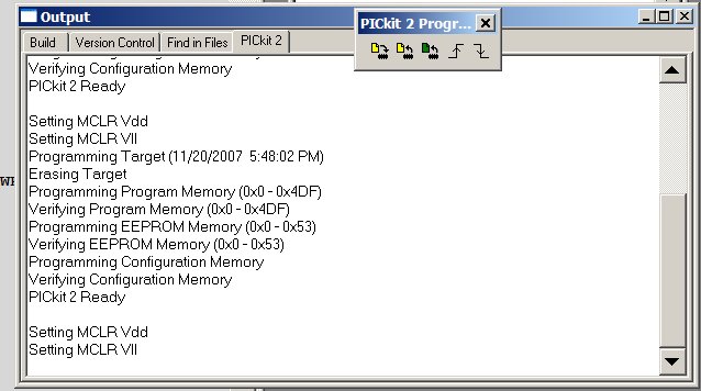

For the simple reason that the Red Push button on my PICkit2 does not have any insignia, I do not use it. Its best not touch unidentified things. That fact is if they meant for that button to be used effectively, it would have been very clearly written in silk screen just like the other holes in the plastic case.
Tip, keep the Programmer tool box real close to Output window as I do.
