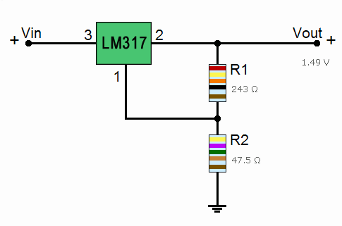

why not build a 1.5 Volt regulator using a LM317 use it in place of the battery?
I did this for an mp3 player, and it has been working for more than 2 years!
figure out what you need here:
