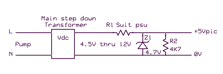

In my home, the main water line pressure is not enough to go upto my tank ( 2 story building ). I used two tanks one down and the other on the roof, and a 1/2 Hp pump ( less than 3Amp ) in between. It will run until the upper tank full and its float closes the inlet and the pressure switch stops the pump.
all this works fine, until the upper tank start to decrease when we use water, the pump starts run/stop rapidly.
My project is to make a circuit to cut-off when the pump stops (upper tank full) wait a period of time (T) and cut-in again.
I decided to use PIC 12F629, but i do not how to tell the PIC when the pump stops. My electrical background told me to wind a conductor on the Phase conductor to get some indication (sort of CT) but still this will be a.c., regardless its amplitude, PIC will not accept it.
so any idea how to sense the current flow in a conductor ( less than 2 Ampere )?

Connect a small low voltage mains transformer across the pump motor, say 4.5Vac, rectify the output from the transformer, use a resistor and a 4.7V zener diode.
Use the PIC input to detect the +4.7V pulses or not.

Hi Eric, thanks for your reply.
Do you mean to make it my self ? or to get a ready one? i have not come across such value, 9V is the lowest i ever seen.
You can use a 9Vac transformer, you just need to increase the value of the resistor in series with the zener diode.
Do you follow OK.?
You could buy a low voltage 'dc' power supply, the type used for mobile phones. Say 4Vdc thru to 12Vdc.... use two resistors to divide the 'dc' down to +5Vdc for the PIC.
If you use this method connect a 3 pin mains socket across the motor supply cable and plug the psu into it.

More or less the zener is going to be either in a conducting state(On) or not (Off), so you would get a 1 or 0, just monitor that on a I/0 pin and problem solved:)

Something like this will do the job.

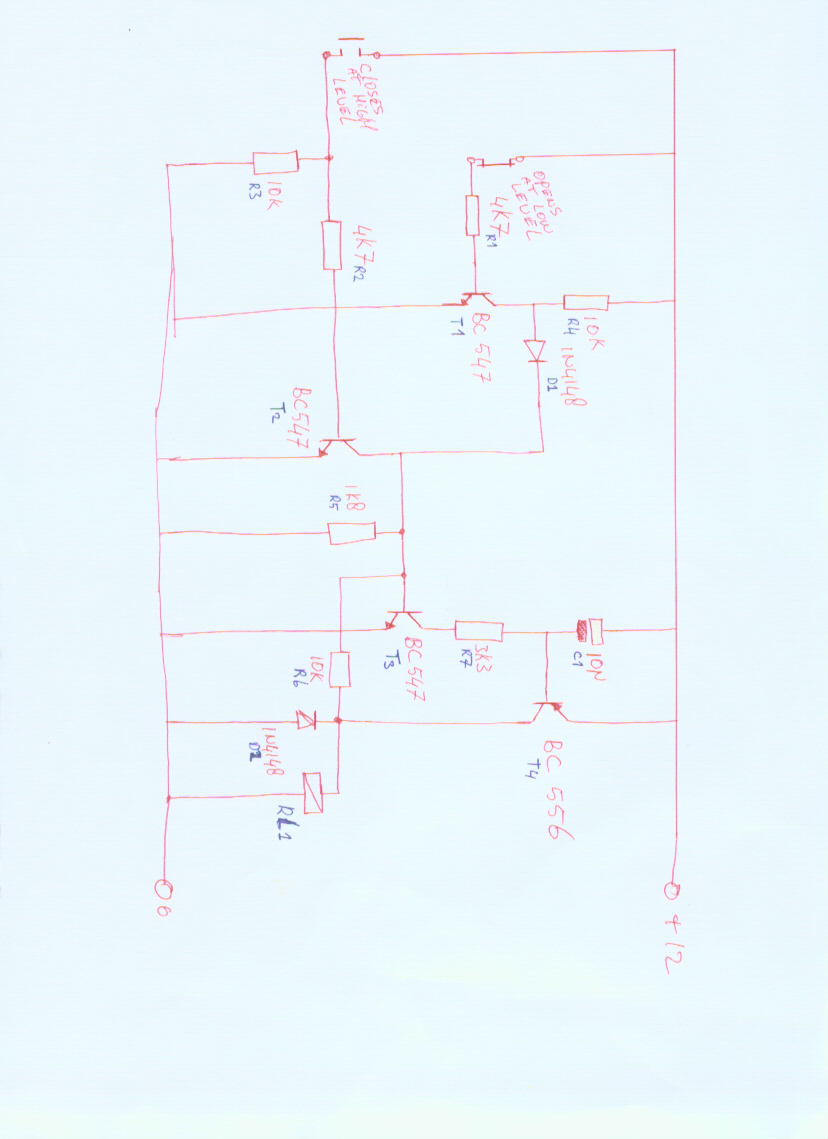

Hi aljamri
This is what you want
the relais (motor) gets activated when the low level is reached it will pump to the high level is reached
when the water drains from your tank the motor will not start again unless the low (fill level is reach again)
This schematic was part of my submition for the competition but was rejected for a still not given reason
i can asure you it works as that i build it my self already and field tested it also
Robert-Jan

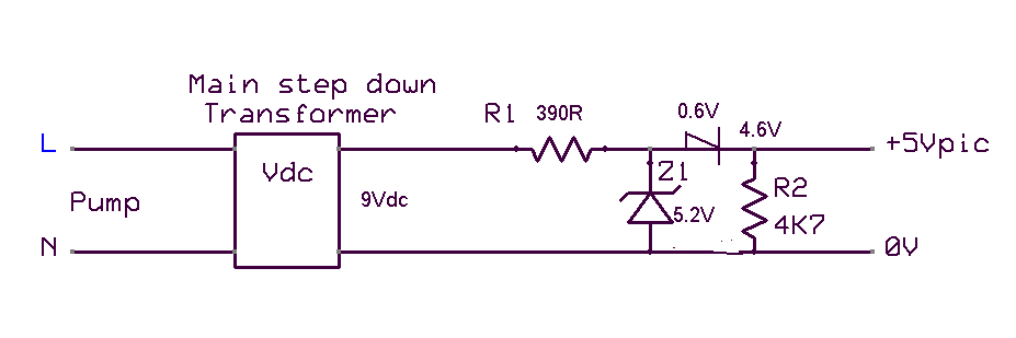

In my junk i found 5.2 v zener diode and a celleur phone charger of 9v output, they will do the job, so you said to tailor R1 to give out 4.7v, in this case 5.2V ?
I'll use Potentiometer to adjust until get 5.2.
Is that right?
Is that right?
Chose the resistor so that you have 10mA flowing thru the zener.
Rs= [9V - 5.2V]/0.01 = 390R.
