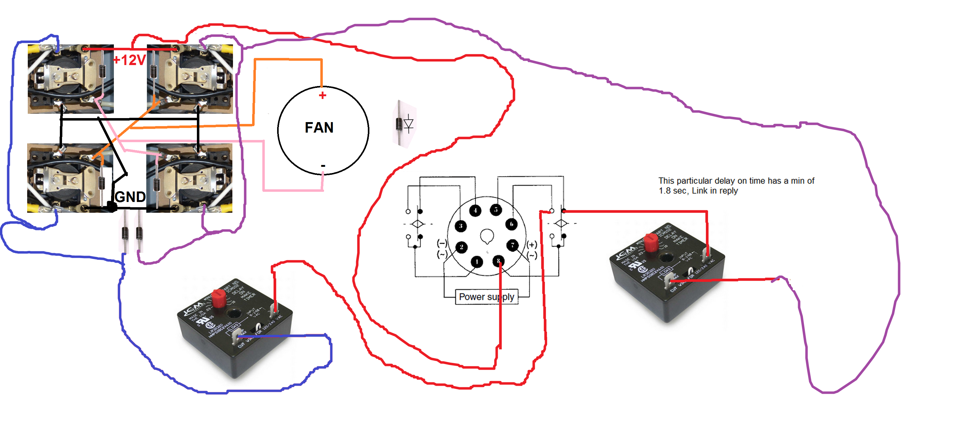

In your pictures on post #11, I see you have some definite purpose relays, and since the fan only draw ~7 amps, may I suggest you use 4 of them to power your fan, circuit drawing attached.
I showed the same two on delay timers as before, but there are other on delay timers out there, basically, the 91.5 timer you have will trigger the on delay timers which energize the 2 relays to send power to the fan, the diodes, as Mike stated are needed. Another timer is https://www.electro-tech-online.com/custompdfs/2013/08/70200052.pdf , it can be ordered for 12vdc and is load independent. There others also, depending on locale and budget.

One approach would be to not to use the Cole-Hersee contactor at all, and just use regular 12V relays.
Kinarfi makes a good point about the "braking" function of the Cole-Hersee contactor, where when neither coil is energized, the motor is shorted to stop it quickly. Kinarfi has one detail wrong, however. Both sides of the motor are connected to B- (gnd); not B+ (+12V). So the question for Armenon is "do you need dynamic braking"?
Here is a new version of my circuit. I have replaced the Cole-Hersee contactor with two new relays U4 and U5, both of which must have a contact rating of at least 10A. This circuit energizes one relay at a time, but only during the "run" time of the motor. See the plots of V(a) red trace and V(b) blue trace. Note the voltage across the motor V(M+,M-) green trace. There is no voltage applied (i.e. the motor is shorted) during dynamic braking.
To simulate this yourself, save the file Toggle1.asc in the same directory as you unzipped the earlier circuit into.
Some Caveats: What happens when your motor (fan) is running at speed, and then it is suddenly shorted? It should stop very quickly, but how large is the current through the shorting contacts? Does this mimic how the motor is actually used? If the current is big (too big for the relays), you might need to provide a "braking path" where a power resistor is switched in series with the motor during the off time, but where said resistor is shorted out during the run time...

These are the relays I replace my over heating contactor with. They are what controls the direction of my winch on my OHV.
I am not absolutely sure that these won't over heat also, but they will handle the current! I got them from eBay for around $6 each.
