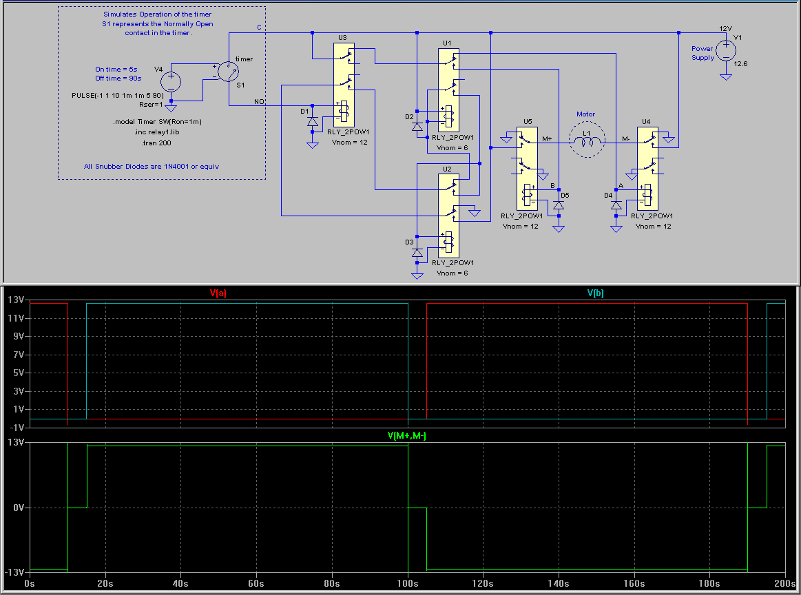

Yes. Look at the Green trace in this image:
toggle1-jpg.75449
That is the voltage applied to the motor terminals.

I am going to run 8 fans at a time. Each fan draws about 7-8amps. Do you think I can still run the test set up with all the fans? Would there be any damage to the diode (1N4001)?

Since the motor current doesn't go through any of the diodes, no.
The two motor relays (U4 and U5)will have to be large contactors like the ones Kinarfi showed in his pictures. Look for regular 12Vdc Contactors;not Starter Relays.

I added a drawing based on Mike's Toggle1.asc and put diodes across all coils + a bridge diode set on the fan, it may be advisable that each fan have a set of bridge on it's terminal, Mike Please Comment.

Right now I'm working on Mike's circuit. I'm going to test it with 1 fan & see if it works. It works in the software. I'll update once I test run the 1st fan.

I have the test set up per the circuit diagram. The fan runs in only one direction though.
Secondly are the diodes arranged correctly (I mean the current flow direction)?

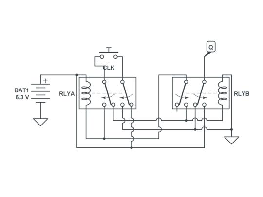

I started late on in the threads, is the schematic a relay flip flop?
The 2 relays with 6v coils might be the issue.
I've used a 2 relay flip flop circuit a couple of times on some old equipment we have.

I believe so. Does it contradict your flip flop circuit?
Nope there are many ways of doing it, the number of relays in your circuit is probably the minimum you need.
Have a look at this:
https://www.emil.matei.ro/onof2.php
I think your issue is possibly a mistaken connection, however if you read the blurb you can see that this and your design rely on one thing about the relay, that the holding current is much less than the pull in current, I suspect that if there are no errors with your circuit this might be along the lines of why it isnt working (not wanting to poop on anyone), the design of the relay plays an important part.
Double and triple check your connections before you condemn your circuit, might be worth building just the push on/push off circuit and see if that works on its own.

That is the reference I linked to way back in post 15 of this thread.
That is also the basis of the toggle part of the .asc files I posted earlier. It simulates just fine with relays that have a hold-in current of ~1/3 of its pull-in current.

I built the flip flop earlier to day and it worked just dandy, definitely going in my neat diagrams folder.
