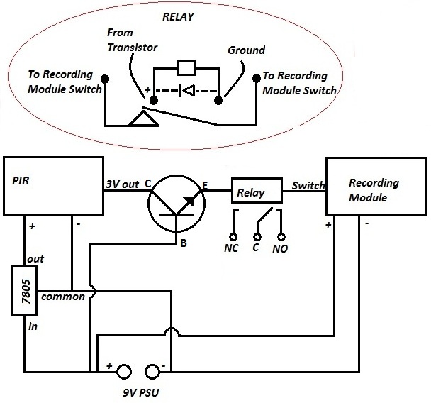

Even though I'm probably talking to myself at this point, the base would connect to the 3V output on the PIR, the collector connects to the + on the PSU and the emitter would go to the relay?
Okay, it looks like this is going to work. My problem now is that i need to find a way to delay the PIR from going off again. The first time it goes off, it will activate the Recording Module. Unfortunately, if there is a second motion after a couple second then it turns off the Recording Module. Is there any way to delay the PIR from activating the relay?

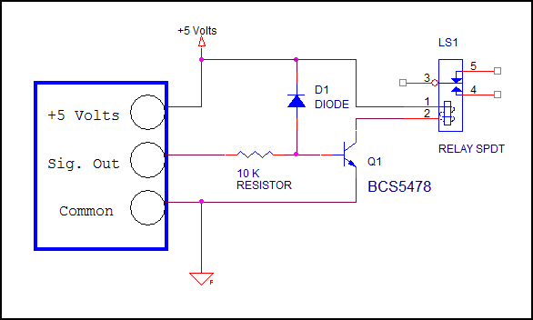

No, no, no. You have some problems in that drawing. You want the output of the PIR to drive the NPN transistor's base. Let me put a basic diagram together.
Ron
You want to set it up like the attached image. D1 can be a 1N4002 and is used to shunt the inductive kick of your relay. The transistor can be just about any general purpose NPN and the transistor base resistor between 1 and 10K depending on the transistor used. The drawing is rough but should give you the idea.
Ron
