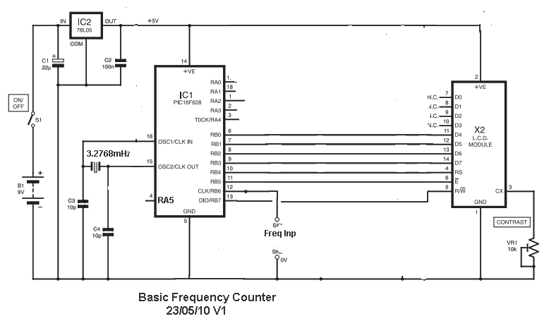

Thank you for posting the link. Ive had a look through it, but ive got to be honest it seems quite complicated, especially for a simpleton like myself. Which ever one I go for, be it the one posted originally, or the one you posted, it will need work. I think the simple 16F84 might be easier for me to work with in the future.
Don't use the 16F84, it's long obselete (last century!) - it was replaced by the 16F628 back then, which is cheaper and more useful.
Exactly, so a version of the one you posted with 16F628A would be perfect, get the LCD to 4 DB's and im golden :)
Look at this asm and image.
Its been tested today up to 2.5mHz, previous at 10mHz.
I have not fully commented the asm yet, but I will add comments shortly.
note: the xtal frequency 3.2768mHz, its a common freq.
Its running in a 16F628A.

Hi Eric,
Thats fantastic, thank you so much! Ive read through and it seems like its nice lightweight code, although I must be honest I will need a day or so to read through it properly and understand in. Again, I really appreciate you helping me with this. Ill keep you posted on how I get on.

PLEASE DO NOT PM me with the same text as your post.
Your example of 0000458 is 458Hz, the zero's are leading zero's, so the display is already left to right
E.
EDIT:
This image is what I see with a test input, please post an image of your LCD display
I have just programmed a 16F628A PIC with that FreqOnly1c.hex, it works as expected, you must have a problem at your end.
Do not PM me any more regarding this Thread.
