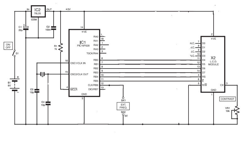

I will post a cut down version of the circuit diagram.
EDIT:
Cut down version showing Frequency circuitry only. [+psu]
You cannot get much more basic than that.:)

Hi. That looks really good, thank you for doing that for me. Can I ask what the IC2 is for? Also, how would this be adapted to use a IR beam break system as the input frequency? Would it be as simple as putting the IR receiver on pin 12?
IC2 is a +5V voltage regulator, its connected to a 9V battery.
If your IR receiver output is at TTL voltage levels ie: ~ +5V and 0V and its NOT encoded, it will count the pulses.
At the low frequencies you mention, its quite easy to amplify the analog signal from a IR detector.
