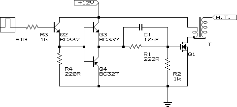

Hello,
I've been trying this for a while (about some weeks).
I built a mosfet driver to drive an ignition coil.
The first driver I've built was very simple, and the mosfet didn't turn off fast enough to generate the "kick effect/auto-inductance/back emf" (I don't know how do you call that :D ) so high voltage was not generated.
I could see that the MOST was not switching off, because I was using an 20A ammeter between the drain and the coil.
I tried with 2 mosfets, IRF3205 and IRF740.
Fail #1:
Sparks were not generated.
Mosfet didn't turn off.
Fail #2:
Some weak sparks were generated.
Mosfet didn't properly turn off.
(I could improve the performance by decreasing R2 value (10k) to 300R)
Fail #3:
Strong sparks were generated.
After a few seconds of working, the mosfet starts to conduct alone. So I have to turn off the supply to "reset" the circuit.
Any ideas?

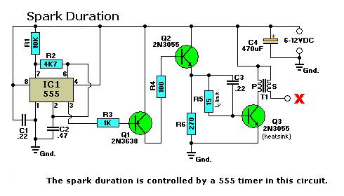

and here's the working one but not mosfet output it's (2N3055) output.

muki55 said:
Just try it!!!!!!!!!

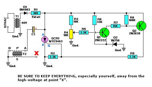

Maybe this one will help. If not: Try tesla circuit. (Just joking) Here's my last one trying to help You. I'm Tryingggggggggggg. hu! hu! hu! hu! hu!
C1- 1uf/200v
C1- 1uf/200v

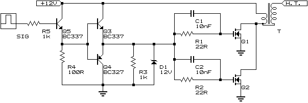

Another thing that is driving me crazy is that I've paralleled 2 MOSFETS and they are heating unequally, when I say unequally is:
One is cold another is very very hot to the touch.
(CORRECTED THE SCHEMACTIC)
Another thing I've noted is that one of the MOSFETS is heating w/o signal applied.
I don't know what it is, because it's the second time it happens, I don't think I'm so unlucky to get 2 pairs of mosfets (each pair in a different radioshack) with 1 deffective mosfet on each pair.
Has anyone pointed out that collector and emitter need to be swapped on the BC327? Having said that, if you are generating the pulses with a 555, it will probably provide higher drive current than you will get from push-pull emitter followers, and you will get 1.4V more gate drive.

What do you mean by swaped? Is this (for example):
BC337: EBC
BC327: CBE
I didn't do that because the datasheet, from fairchild, says that BC327 and 337 have the same leads configuration. (I thought that was strange, but it's the datasheet).
The purpose of the zener is to protect the gate from any voltage higher than 12V.
Ron, Nigel, James,
Sorry, I hooked the transistors right way, but when I drew the schematic I drew it wrong.
In the circuit I've built it is hooked right.
This is the correct schematic:

Your zener will never conduct unless your supply goes above about 13.4V. If it does, either Q3, or the zener, or both will overheat and possibly fail.
What about my other comment?
...if you are generating the pulses with a 555, it will probably provide higher drive current than you will get from push-pull emitter followers, and you will get 1.4V more gate drive.
Why do you need push-pull emitter followers? Are you using a CMOS 555? A bipolar 555 will source and sink over 200mA, IIRC.
Ron, the main problem is that my mosfets are not turning off. :D
Well, the main purpose of the push-pull is to "pull down" the mosfet gate when no tension or low level is applied to Q5 base.
I think that a transistor conducting to the ground do a better job than a "pull down" resistor.
Well, the circuit is working "nice" now, look what I've done a few hours ago:
I connected the circuit in a tweeter with an ammeter, I've notice that it were flowing about 0.5A of current and Q2 (IRF740) were getting a little bit hot.
I removed it (letting Q1 only) and changed Q4 (PNP one).
The circuit worked fine, but when a spark, from the ignition coil HT terminal, leaked and hit the negative terminal...the remaining mosfet were destroyed.
Well, I have to discover what caused the Q2 to fail, with an ohmmeter I measured the resistance between all the terminals (G-S, G-D, D-S...), for my surprise it was about 50 ohms (!!!).
Q2 gate were leaking causing Q1 to conduct as well, causing malfunction in the whole circuit, and probably that was the cause of Q4 burning as well.
But I have no idea what caused Q2 to fail, maybe the it was first affected by the coil back-emf (this is my only guess).
Later I'll try to add some zener or varistor between the drains and sources to protect the mosts against back-emf.
The IRF740 is rated for 400V so I don't think back EMF is your problem. I meant to replace the resistor with the ferrite bead.
However, the last circuit looks quite good to me.
