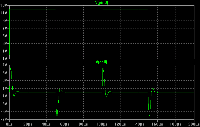

Here's the schematic, and approximately what the waveform should look like. Is this the way you have it hooked up?

Try changing the 10k resistor to 100k The peak voltage will drop, but the ringing should be apparent.

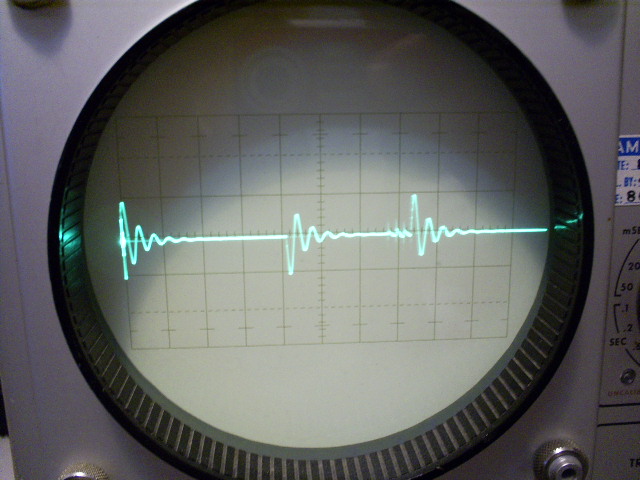

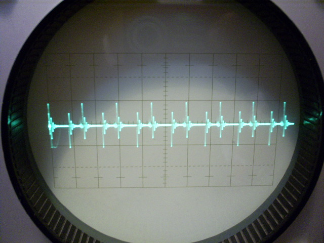

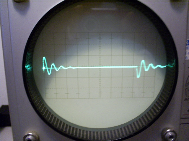

These pics are with a 100kohm resistor between pin 3 and the secondary. The first one is at 10usec/div, second is at 20usec/div and third is at 100usec/div.
Finally we get some useful results. As you can see, the period of the ringing is about 8 usec, which means your resonant frequency is about 125kHz. With 1000 turns of wire, I doubt that the probe capacitance is adding more than 10% to the stray capacitance of the coil, i.e., the actual resonance without the probe is still probably close to 125kHz. There is no way I can think of that you can drive this at 2MHz and get anything significant out of it. The secondary is a bandpass filter. I think your transformer is a dead horse, at least at the frequency you have in mind. You might want to divulge what you are trying to accomplish in more detail. Maybe I or someone else can come up with an alternate solution.
