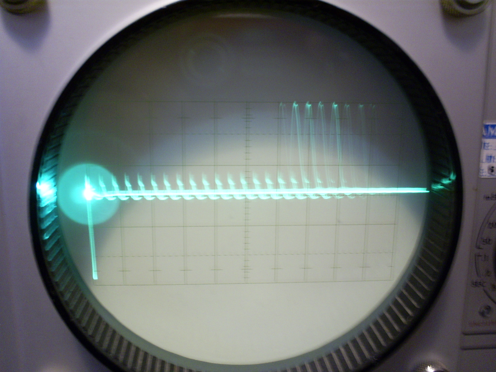

Have you considered the capacitance between windings on your transformer secondary? I suspect that the resonant frequency of the secondary will be less than 2MHz.
turbobill said:
Have not considered that. How do you find resonant frequency of the secondary?
Do you have an oscilloscope? How about a signal generator (square and/or sine waves)?
turbobill said:
I have a scope but not a signal generator.
Set up a 555 timer to run at about 100kHz, and 40-50% duty cycle (not critical). Leave the primary of your coil floating, and connect one end of the secondary to the ground of your 555 oscillator. Connect the 555 output (pin 3) through a 10k resistor to the other end of the secondary. Put your 10X scope probe on the junction of the secondary and the 10k resistor (probe GND to circuit GND). If the Q of the secondary is decent, you should observe ringing (damped sinusoid) on the scope. The frequency of the ringing is the resonant frequency. Be sure you use a 10X probe, because a 1X probe will put a lot of additional capacitance across the coil, lowering the resonant frequency.
You may have to adjust the frequency lower to see the ringing.

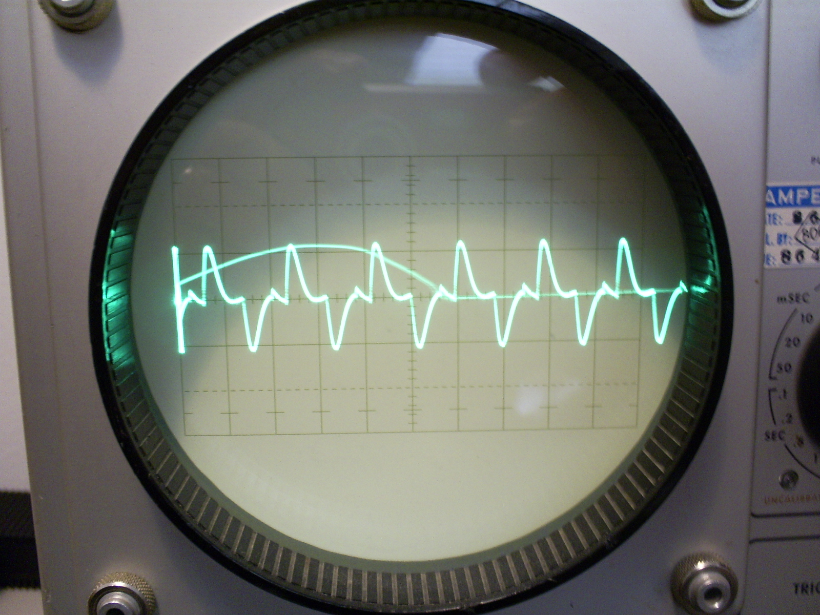

Is this what we're looking for? See attached pic of scope:
The Time/CM is set on 10:mu:s, the Volts/CM is set on .5
Yes, but slow down your oscillator by a factor of about 10 (use 10X the capacitance). Then take another picture.
What supply voltage are you running on the 555? 0.5V peak seems a little low. Is your scope set on 0.5V/div, with a 10X probe, yielding 5V/div actually?
Supply voltage is 12v. Scope is set on 0.5V/div. Yes, using the 10X probe.

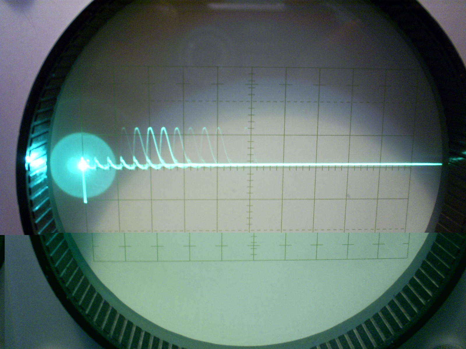

Changed C1 from 0.01:mu:f to 0.10:mu:f, this is what we get. Time/div is set at 0.1ms. What is it suppose to look like?
Can you post a picture at 10usec/div?

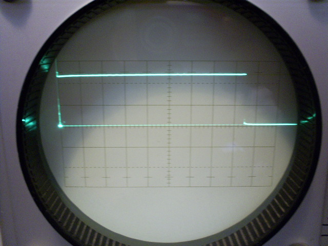

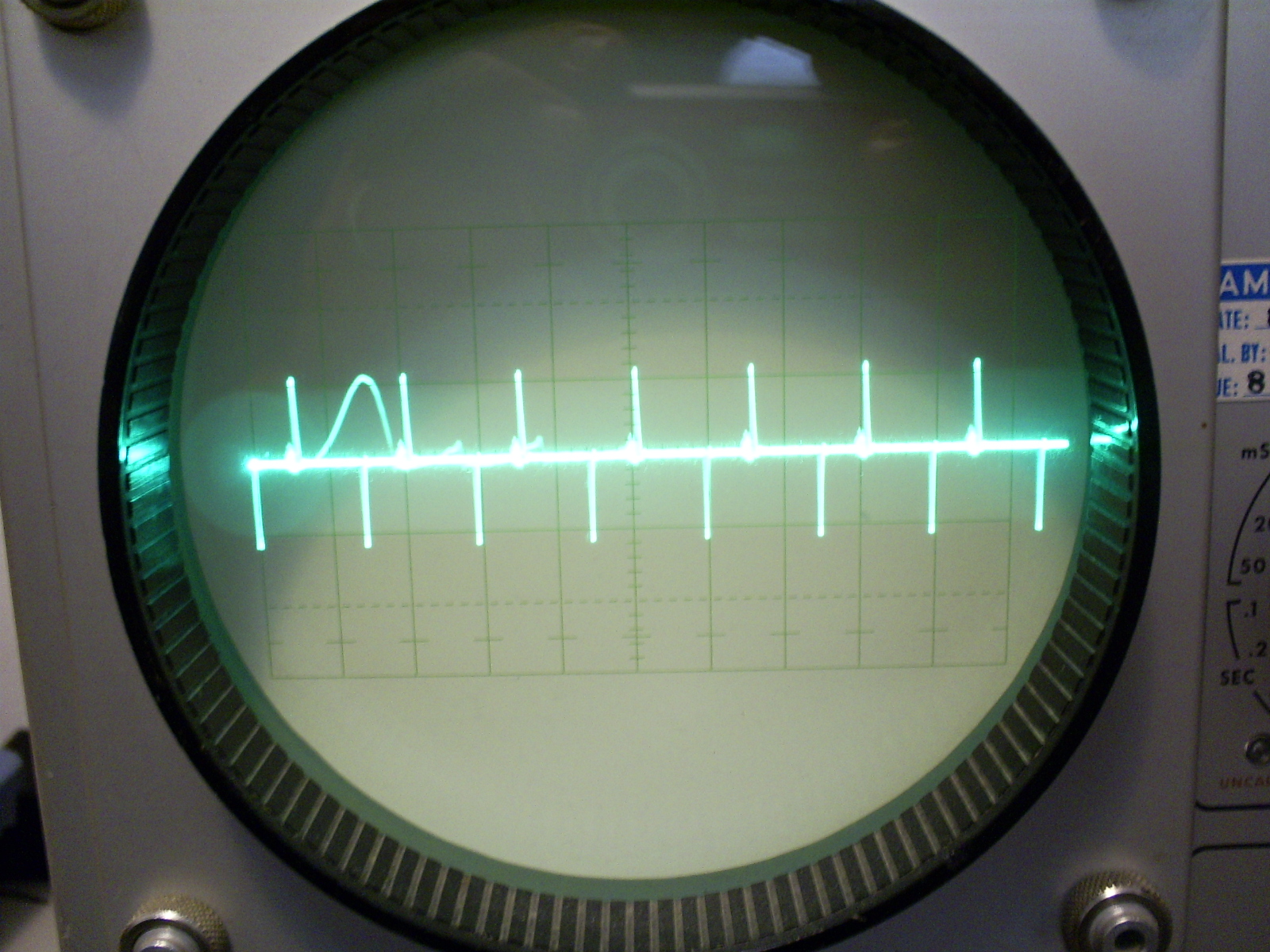

Ok, these pics are both at 10:mu:s, TransFreq3 is at 0.2 Volts/div and TransFreq4 is at 0.5 Volts/div.

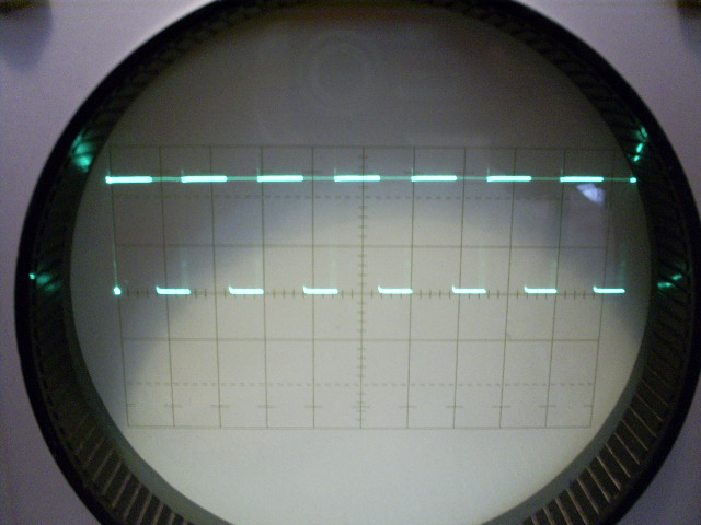

I don't understand what that waveform means. Show us the waveform on pin 3 of the 555, at 10usec/div and at 100usec/div.

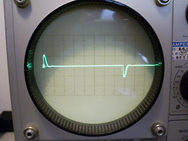

Ok, those two pics were with C1 = 1.0:mu:f. I'm going to drop back to the 0.1:mu:f cap and give you the pin 3 output with out the transformer connected, at 10usec/div and at 100usec/div. Then a series of pics at those same values with the transformer connected.
The first pic is at 10usec/div, the second at 0.1msec/div( I think that's 100usec ), my scope doesn't have 100usec. This is just pin 3 output with out transformer.

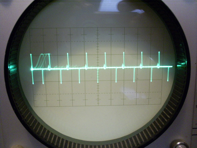

Ok, these pics correspond to the ones above but WITH the transformer secondary connected.
