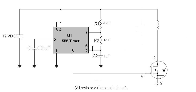

More headaches! I will tell you that just before putting this thing together I tested it on the scope and it was hooked up negative to source, positive to load to drain. The pulse on the drain looked very much like the gate, only cleaner. But when I hooked it up, with no power to the gate, BOOM! :eek:
The MOSFETs are from "ON", part number: NTB125N02R, rated at 125Amps and 24volts EACH.
So as they were in parallel it would seem they would handle quite a bit. But when I hooked up the single 12volt battery( a small mobility vehicle type rated at 35ah ) which doesn't seem to be too much power, it failed. The gate had no power on it so the MOSFETs should not have conducted, right?
Any light shed on this catastrophe is greatly appreciated.

The gate is an insulator with a high capacitance. If your circuit doesn't have a resistor from gate to source to discharge the capacitance and turn off the Mosfets then they conduct enough to blow up.
Three, perhaps obvious, questions: 1) I could not find your circuit anywhere in this thread. Do you have some sort of drain resistor on the gates? You can get enough charge on a gate to turn on a mosfet, and if you don't ground it, it will stay on; 2) You say that you applied power to the source and drain, but nothing to the gate. How did you do that? Is your gate referenced to the same ground as the source? 3) Does each gate have its own resistor?
I was hooking up the battery to the MOSFET switch, drain was hooked to the positive already, when I touched the source to the Neg terminal, BOOM.
No.
BTW. I don't have a digital image of the circuit.
Drain should have been hooked to low-side of load. Is that what you meant, or was the battery directly across the mosfet?
If drain was connected to load, then it sounds like your problem may be in the gate resistors and how you discharge the gates. BTW, one way to test a mosfet is to touch your diode meter to the gate and then check between drain and source. I was surprised how long an isolated mosfet will stay turned on. John

What value is that inductor?

Also you need a low series resistor in series with the MOSFETs' gate to prevent high frequency oscillation - about 10:eek:hm: is normally sufficient.
What's the avalanche energy rating of the MOSFETs? It's possible that they're being zapped by the back EMF from the coil as you haven't connected a freewheel diode in reverse parallel with the coil.

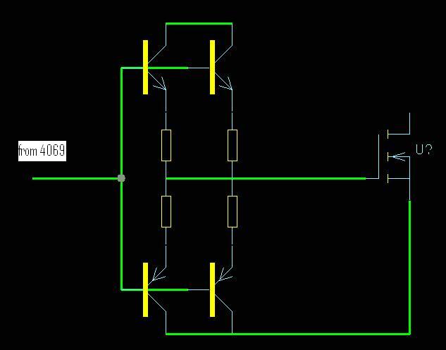

Would someone suggest a possible driver for these?
Are you driving an inductor, transformer, or just solenoid. If that was inductor or transformer, you just applied a flyback design. Im using 2sk1342 900Vds mosfet operating at 300Volt for flyback. When it replaced with irfp460 500Vds it just fail and the mosfet broken.
You can use buffered cmos if there no driver available. For example, this driver has 80ns rise and fall time and only 1Amp peak. Just connect 4069 in paralel and buffer it with KSP2222A-KSP2907A BJT's. The resistor are 22 Ohms (gate resistor).

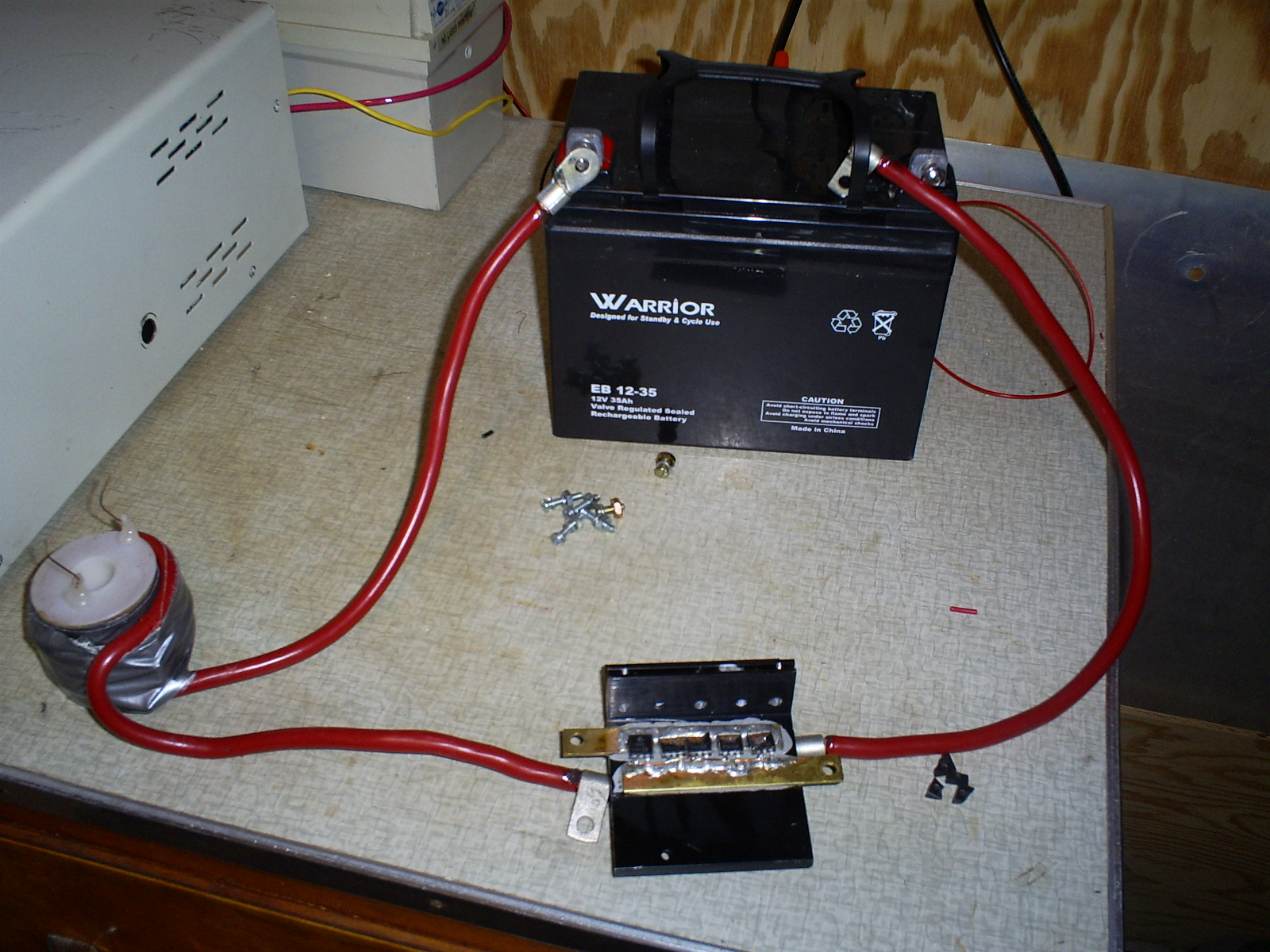

Am wondering if the circuit I'm switching is too SHORT. What I mean is, am I creating a short when the switch( MOSFETs ) are closed? The idea is to get pulsed DC from the coil. Have attached a pic that shows the basic layout, what do you think?

Is your inductor really just three turns of #4 wire wrapped around the 3" bobbin?
I would guess that's about 100 nanohenries, and the current from 12V would increase at the rate of about 120 amps/microsecond. Another way of saying, if you turn it on for more than a microsecond, bang!
Where's your fuse? (I mean other than the MOSFETs). Exploding batteries aren't pretty. Acid burns are forever.

Use more turns on the coil to increase the inductance and calculate it (the formula can be found from Google). Remember di/dt = V/L so if you know how long the coil is switched on for and you know the voltage it's easy to work out the maximum current. You also need to be sure that the MOSFET is adequately avalnche rated for the energy stored in the inductor.
