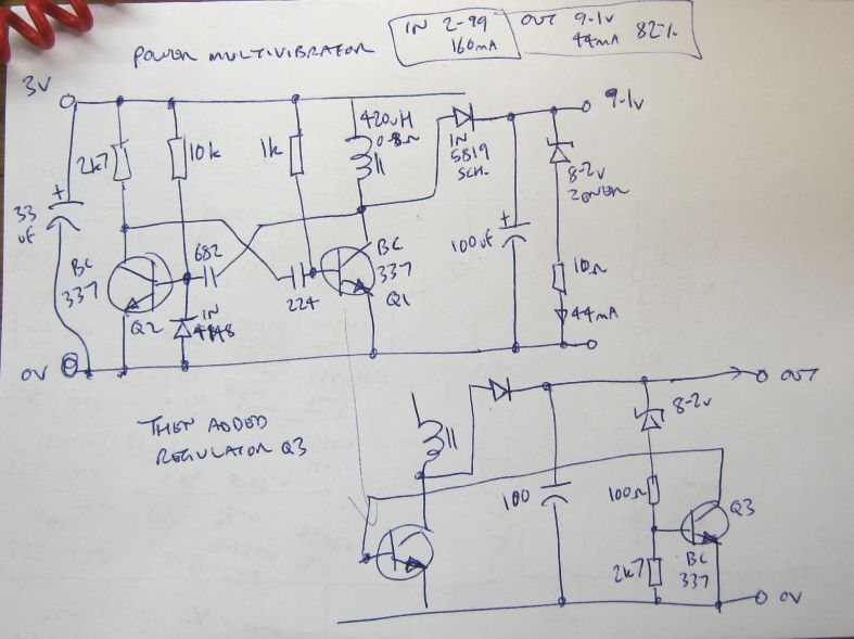

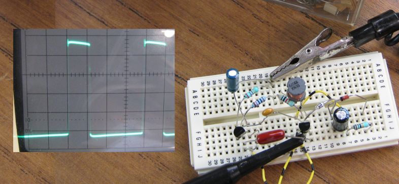

I put some parts values in the power mutivibrator, using the methodology and circuit I suggested all along the power multivibrator was tested first and some values chosen to give 9v and 44mA out with good efficiency. That is the "butter zone" I think for most 9v battery powered applications.
Then added the regulator that has worked so well in the past and did some voltage and current tests;
[b]Power multivibrator first test.[/b]
Vout    Iout      Vin     Iin     Eff%   Freq    Duty
9.1v    44mA      2.99v   160mA   82%    26kHz   68%

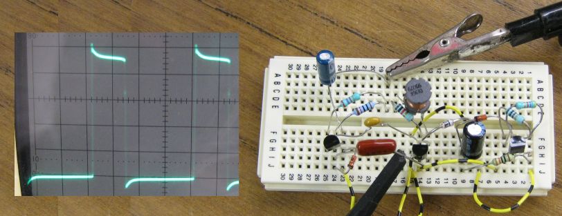

[b]After adding regulator Q3[/b]
8.85v   0mA       3.30v   5mA     0      Chaotic
8.85v   0.8mA     3.27v   10mA    24%    Chaotic
8.86v   3.3mA     3.25v   17mA    53%    83kHz
8.85v   8.8mA     3.22v   35mA    69%    45kHz
8.85v   19mA      3.05v   65mA    83%    31kHz
8.80v   27mA      3.08v   86mA    88%!   25kHz   67%
8.75v   40mA      2.97v   140mA   53%    25kHz
This was all done very rough and ready but proved the methodology; 1 that the power stage was first optimised for good efficiency near the max required current, then, 2 the regulator once added worked flawlessly to control that power stage and maintain output voltage.
This was all done very rough by plugging some parts values in, and measurements too were rough so allow a couple percent on all measurements. However I think it should be capable of 90% efficiency through a tuned Iout band, which is definitely in SMPS IC territory.
Note the waveforms (Q1 collector) are very clean and efficiently switching and the frequency deliberately chosen by the multivibrator values to give good power transfer from that 420uH inductor. It ran at about the same frequency with no inductor at all (just a resistor) showing the multivibrator doing it's job (as I earlier suggested it an be tuned independent of the inductor characteristics, allowing tuning for good efficiency).
I don't think this simple circuit would good be for higher power output levels but it worked pretty good at the Iout I chose (for use to replace 9v battery).
(edit) Checking the photos the resistors on the Q3 regulator base are 100 ohms and 4k7, (not 2k7).

Hate to say it, but my power multivibrator kicks your power multivibrator's butt!
I got a good solid 90mA output (into 100Ω) at a good solid 9 volts. Check my component values (our circuits are otherwise practically identical). efficiency was (I think, have to re-check it) somewhere around 70%, not bad for such a "primitive" circuit.
One thing I'm pretty sure of is that your inductor is waaaaaaay too big. Might I suggest that you retry this with a smaller L? (I'd start with 100µH, which seemed to be pretty much the "sweet spot" with my version.)

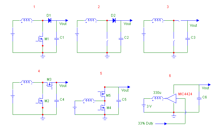

Here's a neat way to use a MOSFET driver.
Have a look at the first attached image. It shows a boost converter and some variations.
The first circuit shows a standard topology with a MOSFET lower switch and a diode upper switch. This circuit has some disadvantages; it isn't protected against short circuits on the output. If you short the output, the input source just flows through the diode and into the short. This circuit is also prone to runaway output voltage if there's no load on the output, and the ouput voltage depends on BOTH the load and the duty cycle of the switch.
Circuit 2 shows the MOSFET replaced with a switch to emphasize that the MOSFET is behaving as a switch. Circuit 3 shows a switch in both positions; of course, the switches must be operated alternately.
Circuit 4 is the same as circuit 1 except that the diode is replaced with another MOSFET, a P-channel type. This circuit has the property that power flow can be bi-directional (in fact if the source and load are interchanged, it becomes a buck converter), and the output voltage is almost completely determined by the duty cycle of the switches (there is a slight dependence on circuit parasitics; resistance of the inductor and the switches, etc.). If the switches are driven at a reasonable duty cycle, the output voltage cannot run away on no load. A problem with this circuit is how to drive the upper MOSFET.
Circuit 5 is the same as circuit 4, redrawn to emphasize that the two MOSFETs are connected in a totem pole configuration.
Now, have a look at this MOSFET driver:
In particular, look at the schematic of the internals in the Functional Diagram on the first page of the datasheet. Notice how the output is a pair of MOSFETs, an N-channel and a P-channel in a totem pole configuration. Those two output FETs are just what is needed to make a boost converter. They are rated for 3 amp peaks and there are two such drivers in the package. The internal electronics takes care of driving the upper P-channel FET. If you apply a logic level to the input (less than .8 V low to greater than 2.4 V high), the output FETs will be alternately switched on and off.
So, how do we use this for a boost converter? The junction between the output FETs apparently should be connected to an inductor, but where do we get the output? The output appears at the Vs connection of the device; connect the output filter capacitor there and take the load from there.
Circuit 6 in the image shows how to hook it up. Connect the two drivers in the IC package in parallel and drive the inputs with a variable duty cycle square wave. The input drive can be obtained in any manner desired; from a 555 oscillator, from a two transistor multivibrator, or as I did, from a function generator.
In order to get .5 amp at 9 volts from a 3 volt source, the 3 volt source will need to supply 1.5 amps; this is what conservation of energy requires. If you're drawing 1.5 amps from the input source, the switches can't have much on resistance. That's why a small power FET would be appropriate here. The output FETs in the MIC4424, which is what I used, are what I would call small power FETs; they can handle 3 amps peak. Paralleling two drivers would give 6 amp peak capability. But, even then the output resistance is rated 3.5/2 ohms, typical. This will cause some loss of output voltage when loaded at .5 amp. It's possible to solder several 8-pin DIP packages in parallel to get lower losses. I stacked 3 packages, for a total of 6 driver stages in parallel. If you want substantially less than .5 amps, one package would do.

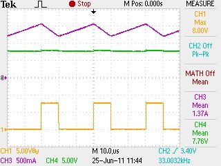

I wired all this up and drove the inputs with a constant 33% duty cycle square wave, fed the input with 3 volts (from a bench supply rather than AA cells). Unloaded, the output voltage would be expected to be 9 volts, completely determined by the duty cycle. Without any feedback for regulation, the output voltage would be expected to drop a little, which it did. But by using an active switch (P-channel FET) for the upper switch rather than just a diode, the output voltage is almost completely determined by the duty cycle.

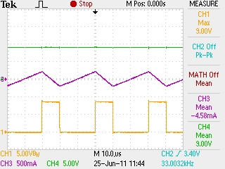

The second image is a scope capture showing some circuit variables with no load. The yellow trace is the voltage at the junction of the output FETs of the MIC4424; this is the voltage at the active end of the inductor. Notice how the voltage the the active end of the inductor goes from zero to 9 volts. The purple trace is the current in the inductor. Notice how the average value of the current is zero. The sawtooth of current is the current sloshing back and forth between the input source and the output capacitor. The green trace is the output voltage, at the Vs pin of the MIC4424.
The third image shows things with a nearly .5 amp load. The average current in the inductor (purple) has increased to nearly 1.4 amps; it never drops to zero. This is what is called continuous current mode. The output voltage has dropped to 7.76 volts and the peak voltage at the active end of the inductor doesn't get up to 9 volts anymore, but only 8 volts. All this is with no feedback for regulation. It would only take a little feedback to the circuit that controls the duty cycle to get good regulation.

Hey, thanks, "The". Even though that kinda violates one of my ground rules (no chips!), what you've shown here is fascinating. I'm still digesting it.
Couple questions: First of all, it seems very strange to take power output from the Vs pin of the driver chip. I guess this is really a "self-bootstrapping" circuit, where the power to drive the inverters, etc., inside the chip will gradually appear as the boost converter ramps up. Neat.
Regarding what happens with no load, even my primitive converter has enough regulation to guard against the voltage zooming up (I just tested mine with open output, and the voltage only rose to 10 volts), so that's not a problem.
Short-circuit protection? that's a whole 'nother thing altogether; frankly hadn't even thought about it (since this isn't even remotely a potential commercial device). But, of course, that would be nice.
Regarding efficiency: my understanding (which may not be correct) is that efficiency depends, at least in part, on having if not the maximum duty cycle possible, at least a sufficient Ton for the switch. Is this a really important parameter here? It seems to be.
It'd be interesting to get one of those drivers and play around with it, see what it can do with a couple of lowly BJTs driving it ...

Think of the driver as just being a couple of small power FETs with associated drive circuitry done for you. You've already run into one problem with FETs, which is their relatively large input capacitance. To get the rapid rise and fall times on the gate which are essential for good efficiency, you're going to have to use some additional circuitry anyway.
Yes. An important spec for this use, which is described in the datasheet, is the ability of the output pin to accept a reverse current without damage. The datasheet says a single driver can accept .5 amp.
Did you do this with the regulation disabled as well as no load? Did you still have D3, D4 connected to the base of Q3 with the collector no longer connected to R6 for feedback? If D3 and D4 were still connected, that would hold down the output.
If you had D3 and D4 disconnected, the fact that the output only rose to 10 volts is an indicator of low efficiency.

Yes; I was trying to get across that my regulator (D3, D4, Q3) actually worked. Of course, without it, the voltage could quickly rise to dangerous levels. But worrying about "fail-safe" protection is about the farthest thing from my mind at this point. I'm not trying to make a bulletproof power supply, only a simple, compact one. One has to trust one's components at some level ...
