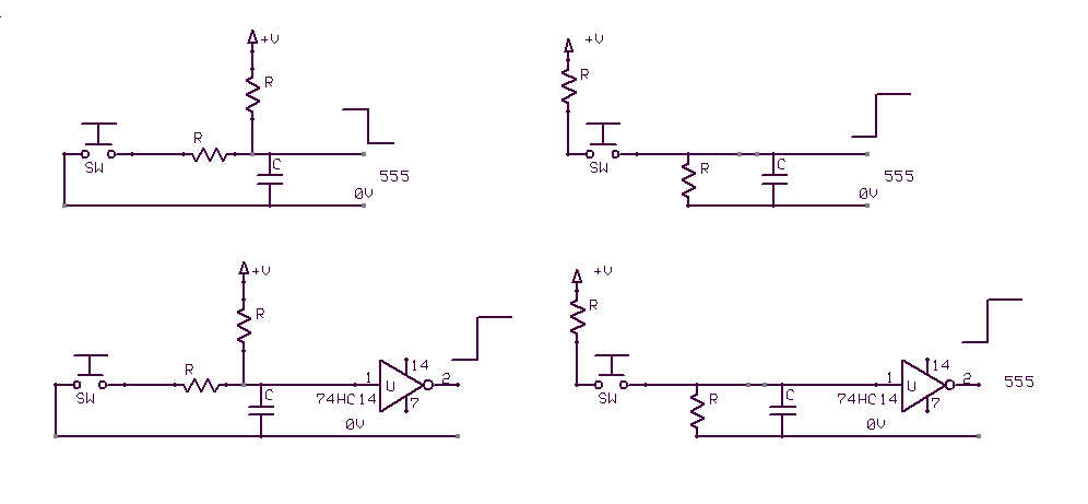

The problem is that with most mechanical switches you dont get a single contact action between the contacts.
They bounce on/off when closing for a few millisecs, as the logic is so fast its senses all these on/offs as signals. These bounce signals can cause your circuits to do unexepected events.
So between the switch contacts and the 555 you need a simple resistor and capacitor circuit.
If the switches are really 'bouncy' you may need an additional ic, eg a 40106 or 74HC14 Schmitt trigger.
Do you follow OK.?

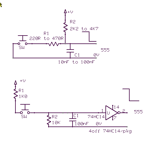

Look at these two options.
I prefer the Schmitt.
EDIT: as you are using 12V, the 74HC14 should be replaced by a HEF40106.

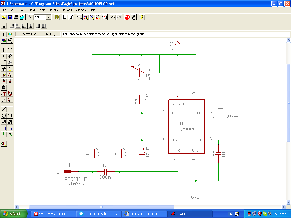

Thanks very much for the quick replies, I have tried a couple of the suggested circuits but anything that alters the power to the switch has a knock on effect of making the other functions of the switch inop. The switch is used to trigger relays for point motors/coloured lights etc. When switched to timed all I am doing is powering up the monostable ready to be triggered by the loco reed switch, if I turn the v-pot to zero it behaves as normal but if the pot is turned up it goes straight into timed mode, after the set time it does reset it self and acts normal.

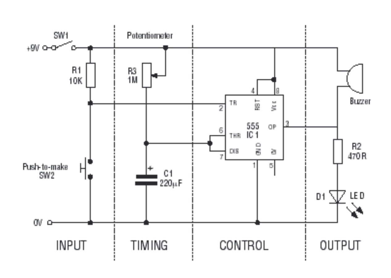

hi eddy,
Is this the actual circuit you are using.?
The circuit is the same, made a couple of changes, removed the power in switch so it is powered from the panel switch, the v-pot is also mounted on the panel and the buzzer has been replaced with a relay

that circuit is retriggerable. I didn't detect any decoupling capacitor either. Also connect pin5 (Control Voltage (CV)) via 10nF to ground.
Hans
Hi, i dont have any trouble retriggering the timer the prob is it triggers when switched on, which i want to get rid of.
So why do you disconnect power then? Every timer circuit produces a short output pulse when energized.

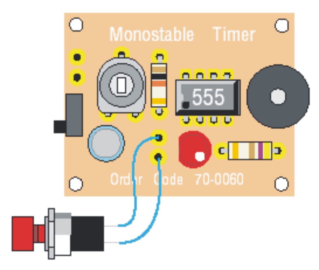

Thanks very much Eric, the circuit board is the same (job lot for school projects) the only changes are, changing the buzzer for a relay and mounting the v-pot and switch on the control panel the longest leads used are about 2ft. The power supply is an off the shelf 3-12V 1A which I tried on 7.5-9-12V all with the same results.

You must have a clamp diode across the relay coil.
The leads to the [2ft] switch should be twisted or screened.
