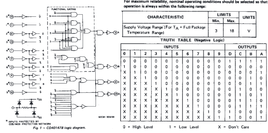

CD40147 or MC140147 has 10 inputs and 4 outputs. If you look at the truth table I think this is what you want. I think there is a 8 in version that can be tied together to make 16 in 4 out. Search for "priory encoder".

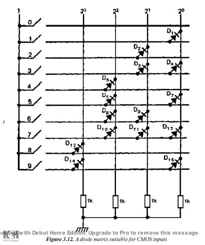

Thank you so much for your prompt response. This is just what I was looking for . I also came across this diode matrix circuit. What is your views on this?

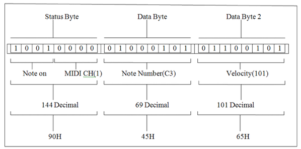

Welcome to the forum Sam, 2 octaves are 24 keys , which octaves , middle C = midi note d'60 , you also need note on / note off and velocity bytes , think mcu required , Monophonic / polyphonic master keyboards would play the last note 'hit'.

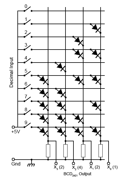

While your circuit does convert one key press to binary it, it does not lock out all the keys to one side.
The instrument must only play the highest key held
Also your circuit will "OR" the keys together, if more than one is pressed.
Example:
key9=1001 out
Keys 9+8=1001 which is ok
Keys 9+6=1111 which is not ok
Also key 0 is the same as no key pressed!
With the IC 0=0000, 1=0001, 2=0010, 3=0011...... 9=1001 and no key=1111
It locks out the "low keys"
If you really want gates etc then you need to design the parallel to serial part first , minimum is 3 bytes as below sent at 31250 bps, could be done depends on your digital logic knowledge. ( midi is optically linked 2 wire pairs)
Velocity and channel can be switches , note on /off and note will have to come from the key scan.
Writing Hi Granddad and Ron thanks. OK I perhaps should give more inf`.
As you properly have gathered my knowledge is limited. This is a steep learning curve. First of all I posted the wrong diagram for the diode keyboard. (Correct one attached
