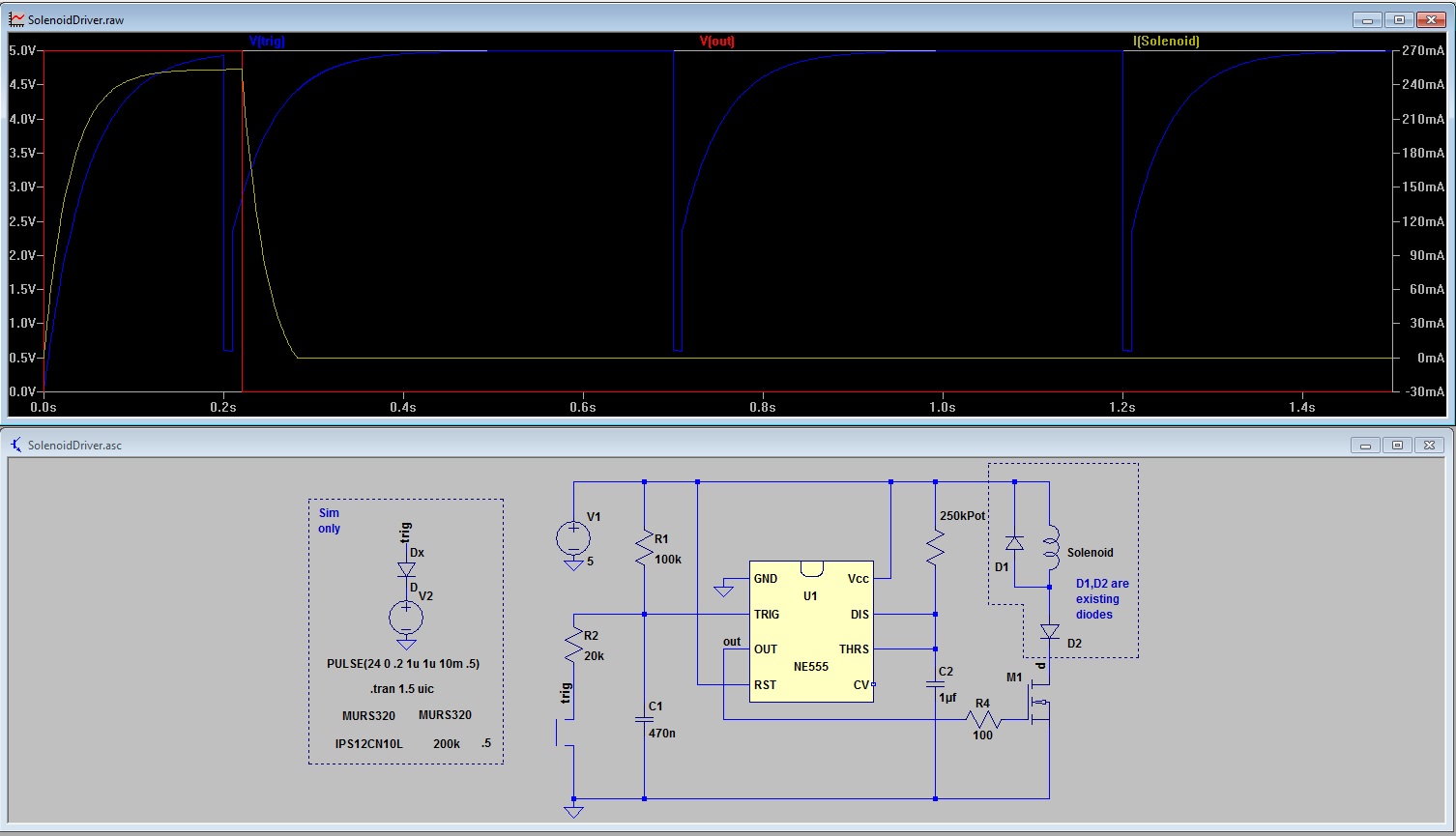

I have ran 2 separate sims that i think will work for me
The first is basically the same as your first alec-t
The second circuit replaces the 1k resistor with a 20k, which seems to knock out any future solenoid activation while the trigger is depressed.
The 1uf cap should of been labeled "1u" in both pictures sorry.
Heres what im hoping will work for me, it allows me to tune the single inputs response via the 250k pot

The link in post #27 is invalid. Can you repost? BTW, the pot is there to adjust the time for which the solenoid is energised, to allow for the current to build up in the coil and for the solenoid to pull in. The lockout time is determined by R1C1. R2 is there only to limit discharge current through the switch, to prolong the switch contact life. It has nothing to do with the timing and its value is non-critical.

Just use an inductor in the sim; say 100mH and 100Ω series resistance.
Why is the distance between the 1st and 2nd pulse always larger than the 2nd and 3rd.

I removed the trigger and r1 from your original post alec-t and when running 250k pot at 180 its gives me a one shot pulse of.2 seconds upon power up.

That's just because of the way the sim is set up with a 0.2sec delay on the simulated trigger pulse. You can easily alter that if you wish. At power-up the 555 circuit is triggered, causing a spurious activation of the solenoid. That could be prevented by adding suitable components to the Reset input of the 555 if necessary.
Attached is a revised asc file for a circuit which I think should meet your needs.

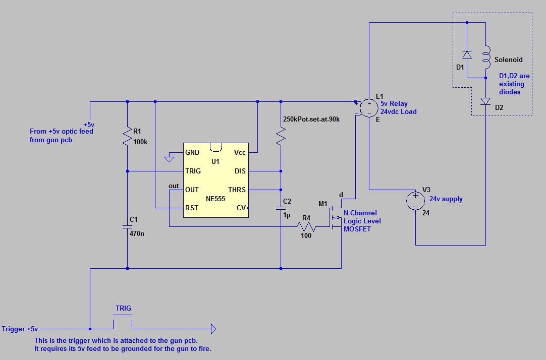

I havent checked your new sim but i wired everything up as id shown in my last post, removing the trigger resistor and such. wired the fet and relay and tuned the pot to 90k and its working with the solenoid perfectly.
70k is where i start to get into problems.

I know this doesn't simulate properly but its the most accurate way for me to show you what Ive done.

If you're determined to use a relay then you must have a reverse-biased diode connected across the relay coil (the same way as D1 is connected across the solenoid coil) to prevent damage to the FET, and spurious effects, caused by the back-emf generated by the relay coil inductance when the relay switches off.
ok ive added the diode, cheers.
Im making another one today without the fet, if its not needed then its just added delay.
should i wire it up like this?
