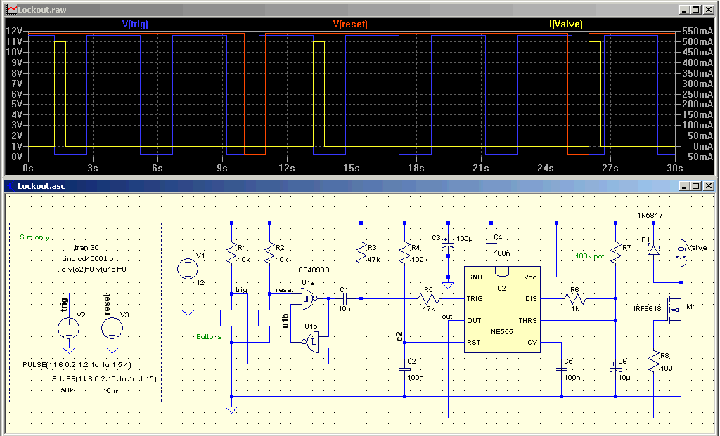

Here's one way you could do it. This circuit also keeps the 555 reset at power-up.
Oh thank you! now it does make sense to me the input lockout! so if I use a 47uF capacitor coupled with 1k ohm resistor and a diode say the same as for the solenoid 1N4007 before the push button input ie from from pin 2 will I be then able to achieve the input lockout?

It looks like the circuit posted by alec in post #11 should do it. Since the timer doesnt have to produce a really really short pulse, the capacitor coupling should be ok, and combined with the latch on the input that will lock out future mis-triggers. We should really do something like that for this application so there is absolutely no chance of unwanted triggering.
Remember also that we need to test the circuit for the time when it is first turned on too. The RESET pin might have to be held low during turn on.
We also have to add a diode across R3 to protect the 555 when the capacitor resets (circuit in post #11).
alec:
What's the additional 47k resistor to the 555 trigger input for?
Also, R6 is too large in value.
Just guessing, but the 47k (R5) looks like it's there to protect the trigger input from the 24V on C1 when the output of U1a goes high. Again, just guessing, but R6 would appear to be there to protect the 555 and the pot when the pot value is low...
If we're talking about the circuit I attached in post #11 then spot on, dougy, re R5 and R6. R6 also protects against excessive discharge current if C6 had a much higher value.
Optional. R5 should keep the 555 safe.
C2 might need to be increased if the power supply rise time is slow.
A cap (1u?) from R2 to ground might also be advantageous, to ensure the latch starts in the right state at power-up.

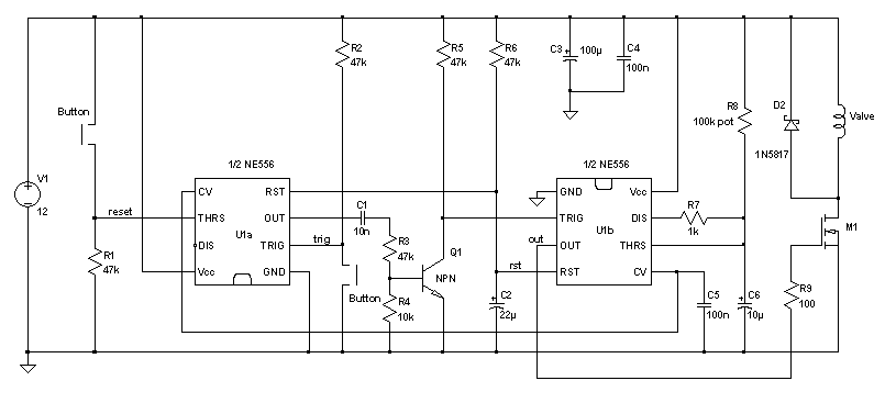

Hello,
Ok, so the additional 47k is there to protect the 555, but do all 555's have built in protection diodes? I dont think so, probably only the CMOS versions. That's why i suggest an external diode.
I've just re-checked TI's NE555 (non-CMOS) datasheet and there's no obvious protection diode so yes, an external diode should be added. My bad. Good catch.

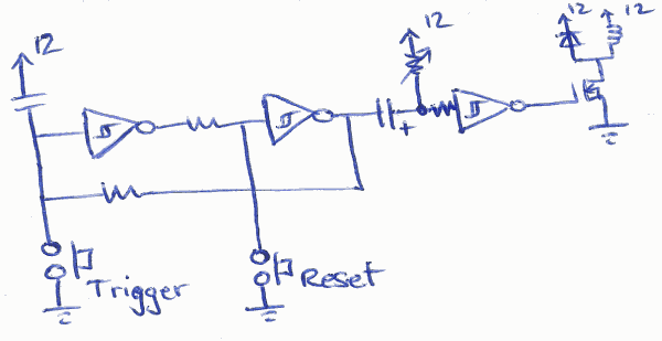

Here's an alternative, using a 556 (= two x 555) to reduce the IC count. Operation is similar to my previous circuit except that the 2-gate latch is replaced by 1/2 NE556 and a transistor inverts its output to trigger the other 1/2 NE556.
Equivalent to the above latching circuit but with fewer parts:

Hi dougy,
Good idea, but you arent suggesting that he use this to also replace the 555 are you?
I ask because we need a reasonably accurate time delay which isnt that reliable with just a cap, resistor, and regular Schmitt trigger logic chip.
I do like the latch part though.
I guess we are waiting now to see what the OP wants to use more or less. But i think a 555 or similar chip is needed for the accuracy and repeatability of the timing pulse.
Yes, I was proposing the replacement of the 555s with the schmitt trigger. Accuracy is not an issue as the time is set using a variable resistor. Repeatability should be OK, though might change slightly with temperature (but so will the R & C values). The threshold voltage temp-co is 0.0005 V/C for 74C914 (https://www.electro-tech-online.com/custompdfs/2013/03/snos344a.pdf)
