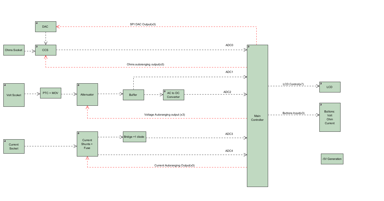

Hi eleclear I landed on your post by coincidence I am currently thinking of building the same thing. Please see the attached file. What you see in there is a prototype but in the end the oversampling microcontroller will get replaced with a 16bit SPI ADC. I have started testing my voltage attenuator, and ohmmeter part. I need to carry on with the other blocks. The final microcontroller will change as well and the PWM will be replaced with MCPXXX dacs. I am not trying to build an industrial multimeter but rather have one I can use and fix myself if something goes wrong. Its also more a learning project and I try to keep it fun.

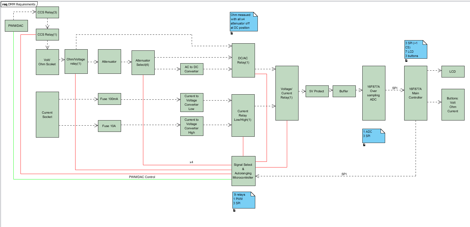

Hi DirtyLude I wanted to find a way to build an oversampling ADC using a pic. The reason I did that in first place was because I had defined an array filled it with all samples and them average all the values. Since the 16F877A has only 368 bytes of RAM and getting 255 samples in was challenging so I initially went for 2pics. I then found a work around where I used a different cumulative technique instead of an array and I was able to get my 255 samples in. The second reason why I used 2 pics was for response time. Once microcontroller would be busy sampling while the second one would take care of handling LCD display and control. If my second scheme ends up being slow I will have to go back to 2 pics
