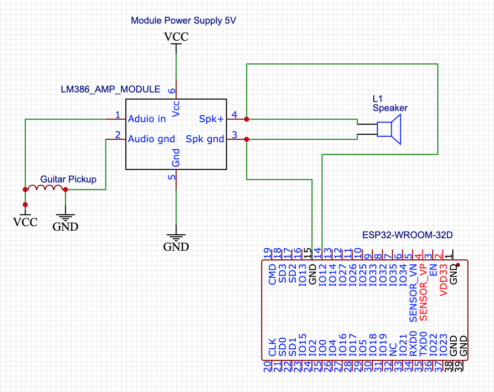

I am working on detecting the amplitude of a signal coming from a guitar pickup. I am using an esp32 and an LM386 module for amplifying the signal.
I get quite stable readings with a multimeter, but the readings on the Arduino IDE show peaks and also peaks come when no signal should be there.

Diagram:
Thanks!
It doesn't help you're trying to measure an AC signal with a DC converter, you're never going to get a sensible reading - you first need to convert the signal to DC.
I solved it by averaging the values over 500 cycles.

The true average of an AC signal should be zero. But the way you are doing it I think it will be treating all the negative values as zero so your result would be about half the average of the positive samples. As Nigel has told you you should use an active rectifier to convert the AC signal into a DC signal. An alternative would be at add an offset value equal to half the full scale reading of your ADC to your AC input signal. You would then need to use software to convert all readings less than half the ADC full scale to the corresponding positive value. You would also need to subtract half the ADC full scale value fro all the readings greater than half the full scale value.
Les.
