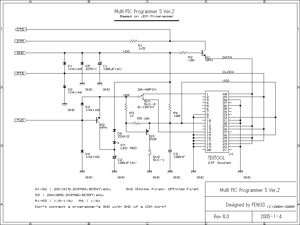

Microcontroller Programmer!!
Multi Pc Programmer
hi. who made this programmer it seem easy and simple i want to use it dose it work with all pc?
the shematic and SUPPORT all pic micro
I would say not, as it's based on the JDM, the most unreliable programmer there is, and the one that has most problems with specific PC's.
I would strongly suggest building a Junebug (PICKit2 clone).

thank's for your suggestion i'll build PICKIT2 clone programmer
personally, i did not experience reliability issues with the JDM. its a good one to start with, most certainly because of the ease of building it.
I have no doubt that it works well for you but please do you homework. This post could cause other people problems.
The JDM depends on the RS232 port having enough voltage to make it work. The newer your computer is the less likely it is that the RS232 will have that voltage. In some cases you will not even have an RS232 port.

This is the sort of thing where it will work for some and not others. There are easy to build programmers that do not suffer from this problem. A parallel port or serial port unit that does not depend on the RS232 port for 12V is a better choice. LVP can also be considered.
It is a bad idea to encourage people to build JDM.

hi again, since i am about to embark on the wonderful journey of cloning of a junebug i wanted to ask several questions:
What does Vpp,Vdd,HVP,LVP Mean?i readon some posts here that some chips use HVP and others use LVP and whats the diffrence between Vpp and Vdd in te programmer?
Clarification.
A JDM-ish programmer by definition takes the voltage for VPP directly from the com port. If you use an external supply or a charge pump as you suggest below it is not JDM. It is only the JDM-ish programers I have problems with

As long as Software driver recognizes it as JDM, we may call it JDM or JDM clone if not JDM-ish. once Job is done, it is fine.
Y-day, I had assembled the JDM in its original form. I understand that 13.5 generation is taking time as it is a combination of 5.1 and 8.2V zenors. each having 100uF filter, it is taking time thus the early words are not getting loaded perhaps.
I am not pleading JDM but instead of calling cheap or costly as some comment, let us examine what exactly troubles it to behave erratic
perhaps a diagonistics can be conducted on it
I do agree that nothing to beat PICKIT2 or Junebug.
You may call it anything you wish. But if you do then we need to qualify the warning regarding JDM programers to differentiate between real ones and ones with the problem fixed.
My view is that a programmer without ICD is only useful in building your first programmer with ICD. To that end, it only needs to program 1 chip once. Not much point putting a lot of work or design into them. I still think using LVP is worth a try as we talked about earlier. A few resistors on a bread board.
