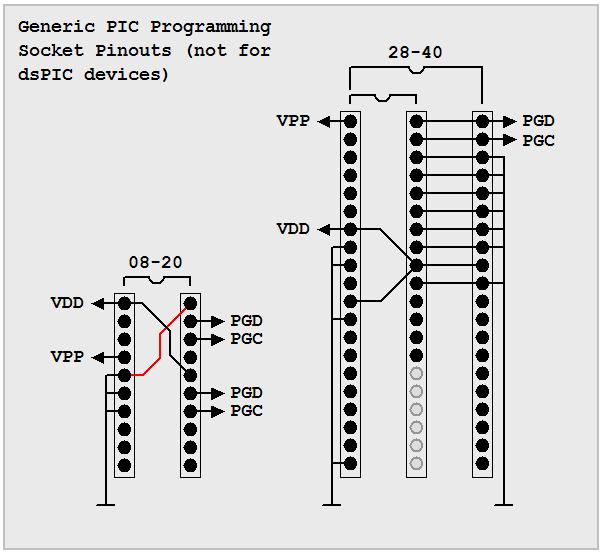

Hi 3v0,
Just design your "combo sockets" so that pin 1 always goes in the pin 1 position. Here's how I did it on a home-brew programmer adapter long ago (using single-in-line machined pin sockets). Use the little 20 pin socket for 8 pin, 14 pin, 18 pin, and 20 pin PICs.
pic-programming-sockets-jpg.8323
Also, check out page 2 of this old thread where we discussed using a 40 pin ZIF socket (or three 20 pin single-in-line machined pin sockets) with two ICSP connectors and "flipping" the adapter 180° for 8-20 or 28-40 target devices.
