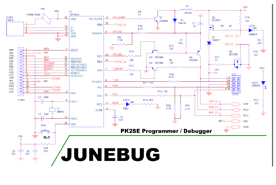

i am going to clone of get cloned the junebug.i read from the junebug assembly instructions file that mplab writes the firmware hex file so i dont thin i need to get it programmed if i do need to get it programmed than where can i find the code and is the circuit which i am posting here from the file complete.and i have downloaded mplab from mcirochips website. does it support all pics ??:confused:
QUOTE from JUNEBUG Assembly Instructions April08:
"Your kit includes a pre-programmed PIC18F2525 (PK2V021000.HEX) the firmware is automaticallyupdated by MPLAB when needed. If you have a problem with the firmware holding down SW5 (directly below the 18F2550 while you connect the USB cable should initiate the bootloader (busy LED flashing)Run either the PICkit 2 or MPLAB software to initiate a reinstall of the Junebug (PICkit 2) firmware."
So If you assemble a kit supplied by Blueroomelectronics with a pre-programmed 18F2550, what you read is correct. Otherwise you may have to get the Firmware loaded thro' a known friend. Luckily for you, Mike k8lh has offered HELP in this very context.

well what do you know writing in your location really helps!!My name is Abbas Shah.and as stated above can you give me the hex file for the 18f2550 in junebug?as soon as i have hte hex file than i can start the cloning of the junebug!:p

Nope--as far as I know, only Bill has the firmware code for the Junebug, seeing as it's a kit that he designed and sells on his site: https://www.blueroomelectronics.com
I could not find Junebug firmware to download on Bill's site but the Inchworm programmer firmware is available on the Inchworm product page.
Bill, by the way, is a long-time member of this site and is one of the top respected posters helping people out here. Perhaps if you ask him nicely he'll send you the firmware. However, I suspect that he charges money for it and since he makes money selling his Junebug kit I don't know how willing he'd be to just send the firmware to someone for free. I wouldn't. Maybe Bill is nicer than me though.
Will the Inchworm firmware suffice? If not, I'd suggest just buying the Junebug kit. It's an amazing deal at $49. Or as was already suggested, a Dragon if you want to work with AVRs.

Umm... Junebug is a PICkit 2 clone. That means it runs Microchip PICkit 2 firmware, right? Isn't the firmware you're looking for located in the Downloads section at the bottom of **broken link removed**, listed as "PICkit 2 Firmware V2.32"?
My apologies, you are absolutely right. I thought the Junebug was just compatible with custom firmware, not a clone.
Futz is right, I was wrong: it looks like you can just download the code from MicroChip.

yes, all the firmware and software you can download from MC site, but I recommend you download software and firmware version 2.50. because last time I have experience with Real PICKIT2 from MC, when I update to 2.52,sometime, there are error when I burn the chip. I just work fine with 2.50. I not sure the other members have same problem like me. May be it because of my laptop i used.
Now I used 2.50 and it work fine.

:) Thank you Torben for the compliments. The Junebug (PICkit2) firmware can be found within MPLAB or the PICkit2 stand alone application both freely downloadable from Microchips web site.
Look for BL01*.HEX or PK2V*.HEX
MPLAB and PICkit2 software will autoupdate the firmware so you can pick either.
thanks very much mike!i can get it programmed but thanks any ways for the help will pm you if i find any problem!i am going to post the picture of the clone as soon as it is made.
i am not getting any results for the names given by bill. is the hex file given by futz not the correct one?
thanks for the link bill. one last question is that the socket for the programming ic is 16 pin(con3) rite. so will i not be able to program ics having more number of pins?
