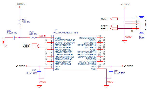

Hello,
I'm putting together my own PCB with a PIC24FJ64GB004 (28-Pin SSOP package) and just started with the basic circuit following the datasheet. I'm posting it here to make sure I have it correct or if I'm missing anything so that you guys can advice. I will be using the PICkit 3 to program the device and I think I have the ICSP connector correctly wired.
Any ideas and input will be appreciated.

For starters, there are errors in the pin numbers and their associated functions in your schematic. For example, your schematic shows pin 20 as VUSB when the datasheet says pin 20 is Vcap/Vddcore. I didn't check all of the pins but there are likely additional errors.
Next, your DISVREG pin needs to either be connected to Vdd to disable the regulator or to Vss to enable the regulator. Depending on how you plan to power the core of the controller will dictate if you need to tie the Vcap/Vddcore pin to Vdd or connect a low ESR capacitor between it and GND. If you are running your board at 3.3V which is what your schematic says, you will need to ground DISVREG and use a 10uF cap on Vcap/Vddcore (See section 2.4 of the datasheet for more details).

Hi drkidd22. Personally, I would use a 1N4148 diode in series with a 10K resistor to MCLR, but I have heard that just resistors work too. I just use a diode with the resistor just to be on the safe side. Just another suggestion that you probably wouldn't need, but may be worth considering (depending on what you're using this for).
Good luck!
