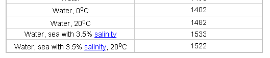

I think this is an interesting concept. I could not find the speed of sound in sulfuric acid solutions, but as an approximation, I did find results for salt solutions (i.e., another ionic solution):
The right column is velocity of sound in m/S.
3.5% salinity is approximately 0.6 mol/L, which causes an increase of 2.3%. Battery acid is quite a bit more concentrated with solute (sulfuric acid) when charged. This approach will probably need to include a temperature correction. I will keep looking for some data on sulfuric acid solutions; although, looking for a maximum velocity with temperature correction makes sense. Let's hope velocity doesn't decrease past a certain point. ;)

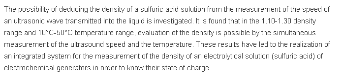

OMGosh, we are reinventing the wheel. Here is an IEEE on this very subject (**broken link removed** ):
Unfortunately, I do not belong and can't access the full article. Nevertheless, someone who does can summarize the findings and post data from the tables without violating copyright.
John
Nice find, JP. That would suggest that the elasticity modulus is essentially constant.
