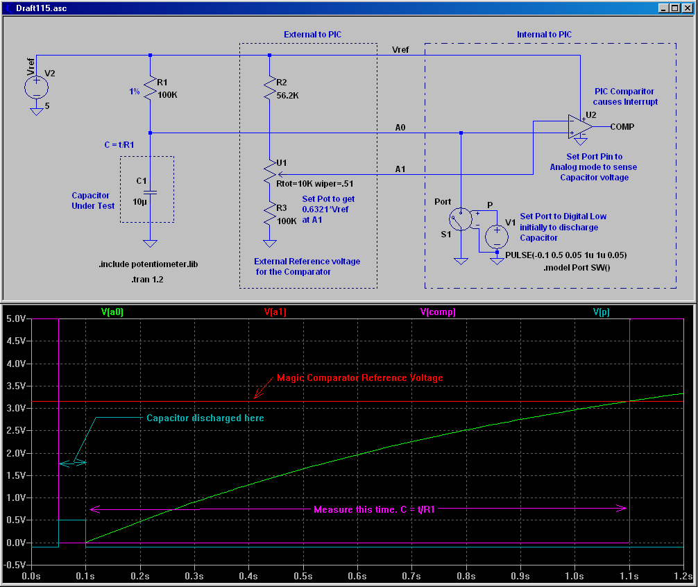

Here is an "improved" way of using the comparator. Note that I'm now using an external means of setting the trip level that makes the math from converting timer reading to capacitance easy. The underlying math is shown here.
Also note that I am using the same PIC pin to initially discharge the capacitor by initially setting the pin as a low digital output, and then subsequently setting it to an analog input, which allows the capacitor to begin charging. The comparator trips and generates the interrupt to save the timer value when the capacitor charges to ~3.79V, which is one RC time constant, which makes the math easy.

im sorry for not understanding much still maybe because i dont know how comparators work or how to set one up but i still dont understand why you need that Pot. there? Why do i need a external reference voltage? Why not use internal VDD,VSS ?

hi atom,
Just in case Mike is off line.
The Vref is the +5Vdd and the pot is to SET the 0.631*Vref point.
Mike,
I am not sure that a PORT pin can 'dump' a 10uF or higher cap without damage.?????
