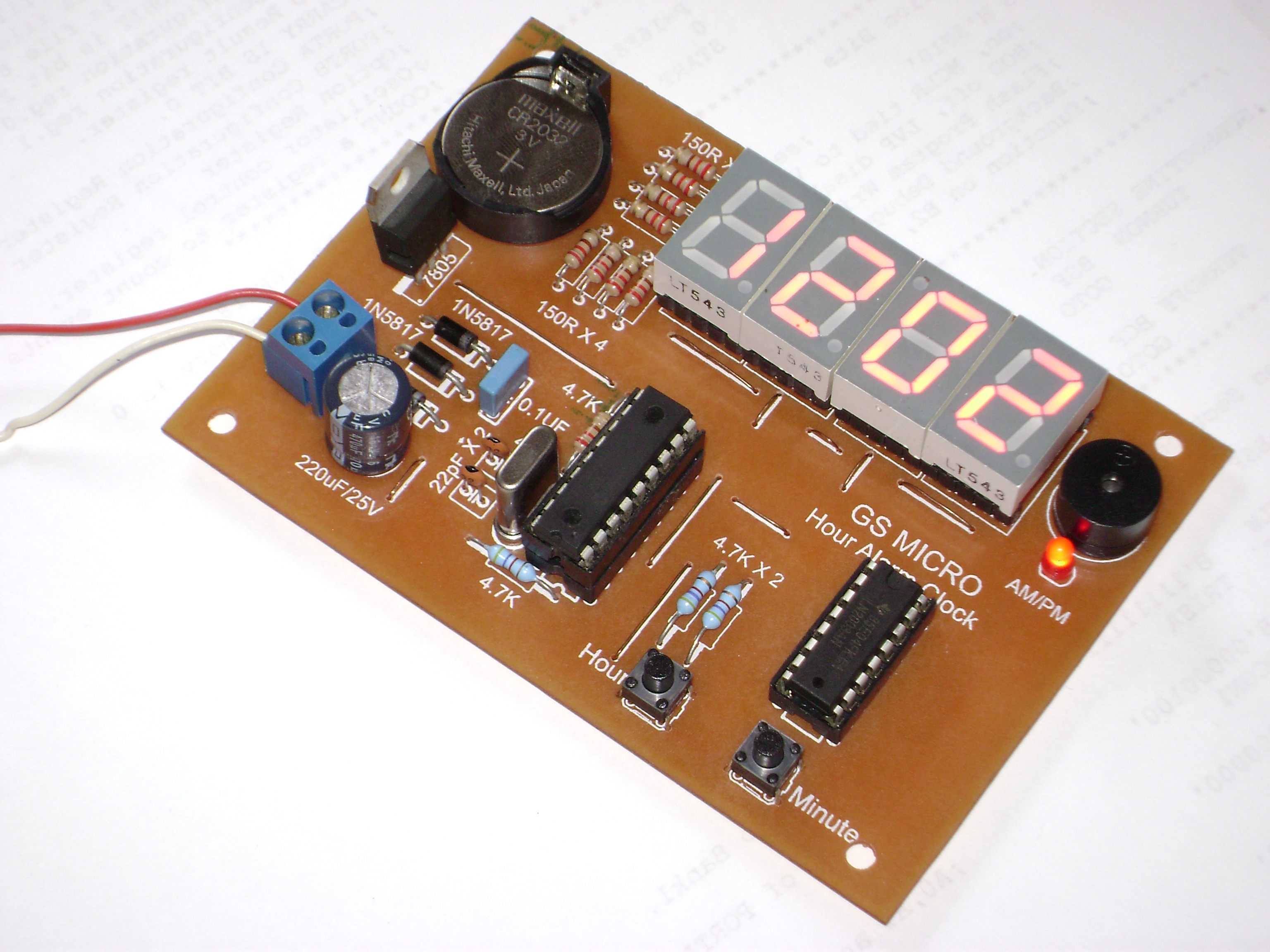

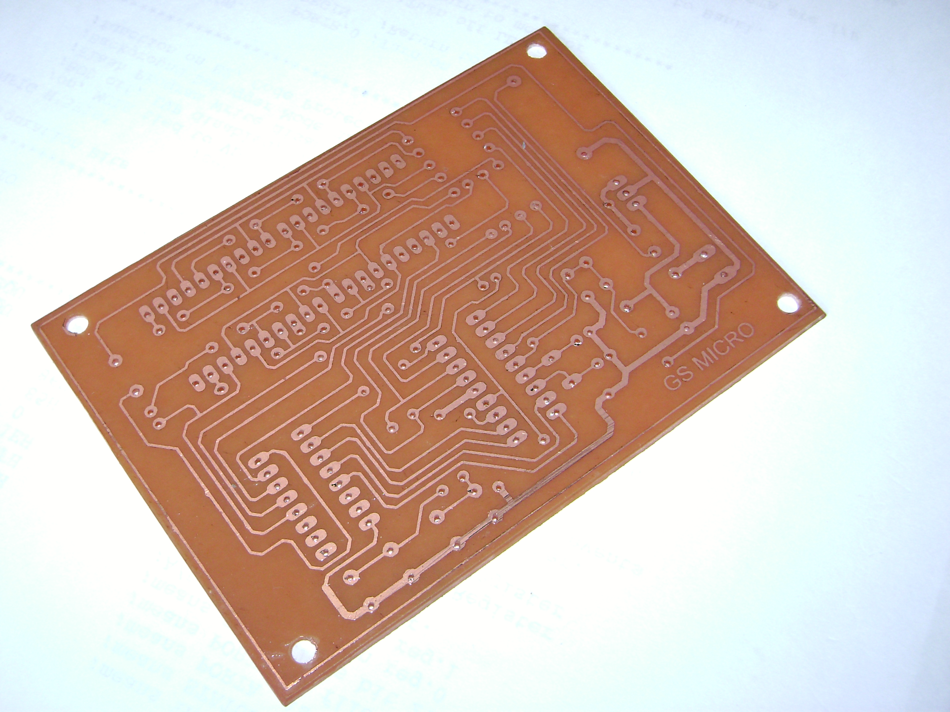

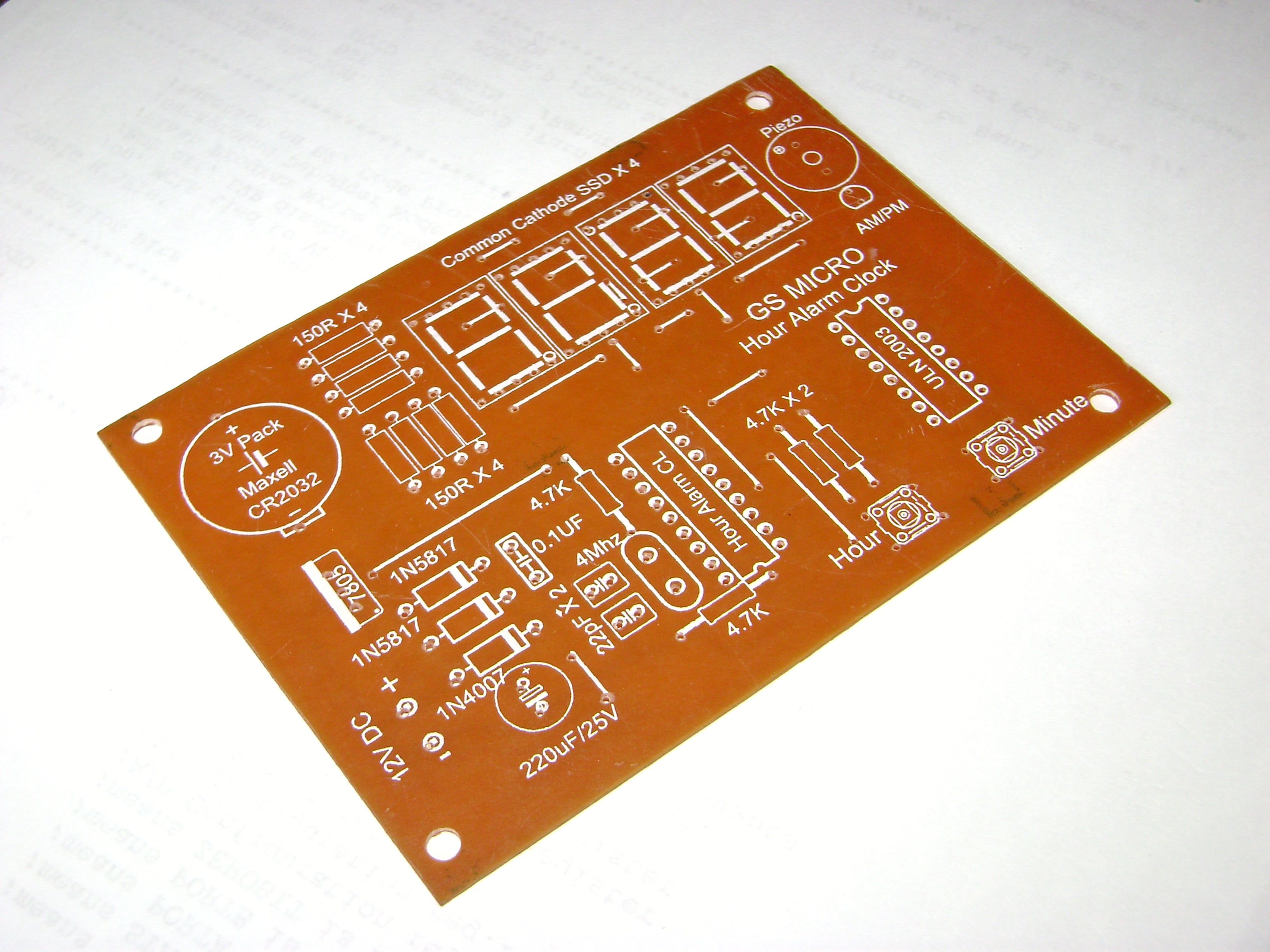

Ok guys I have managed to reduce the power consumption as much as I can.I've reduce down to 125uS during the main DC power supply failure.
I like to show you some pictures of my design.

Very nicely done indeed!

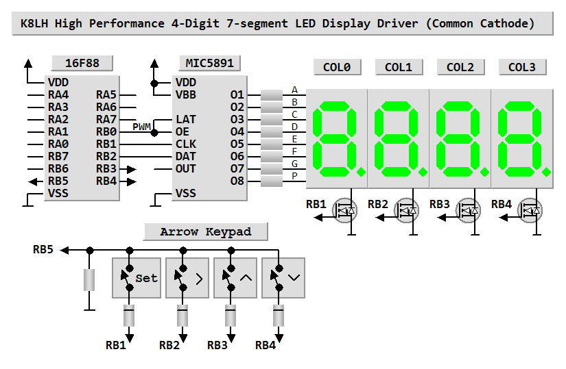

Yes, you're right. The Timer 1 oscillator pins are on RB6 and RB7 on a 16F88. You'd have to split the ports and you might end up short of pins.
If I ever get around to trying it I think I might do it like this;
k8lh-4-digit-display-png.28031
RB0 through RB4 are used for the display and RB5 is used for the switch inputs. RB6 and RB7 can be used for the Timer 1 oscillator function. This leaves RA0 through RA7 available for other functions.
Food for thought...
Mike

Hi Mike thats a nice way of doing.Thanks for your idea.Its really helpful for future upgrades.

Digikey sells them in the DIP-16 or SOIC-16 package for 2.43 USD (quantity 1). A less expensive alternative might be a 74HC595 and eight P-FETs.

There seems to be a much larger selection of serial-to-parallel sinking driver ICs (TPIC6C595, MIC5821, etc.) which seem to have better pricing too. These would work great with PFET column drivers on command anode displays.
