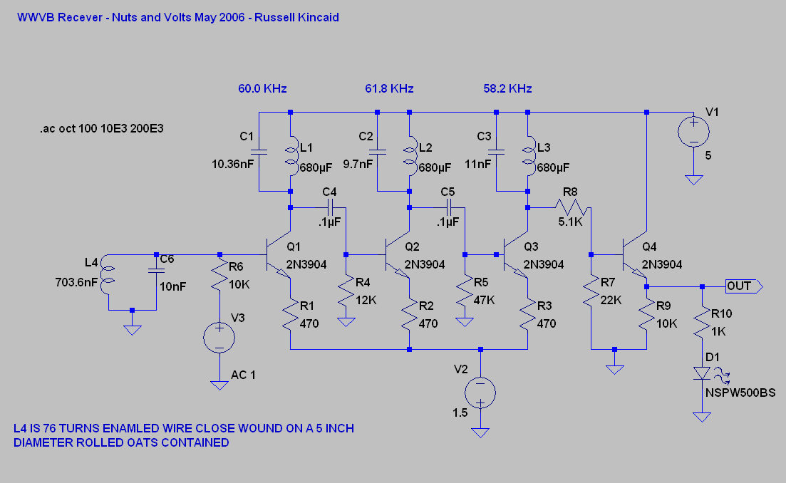

I have a schematic for a WWVB reception indicator which calls for 3 680uH inductors.
I was wondering if this part would work (Mouser part no. 434-17-681J).

FWIW, they are all part of LC-tanks (freq. around 60 KHz), so I figure I can compensate for inexactness in the inductance value on the capacitance side.

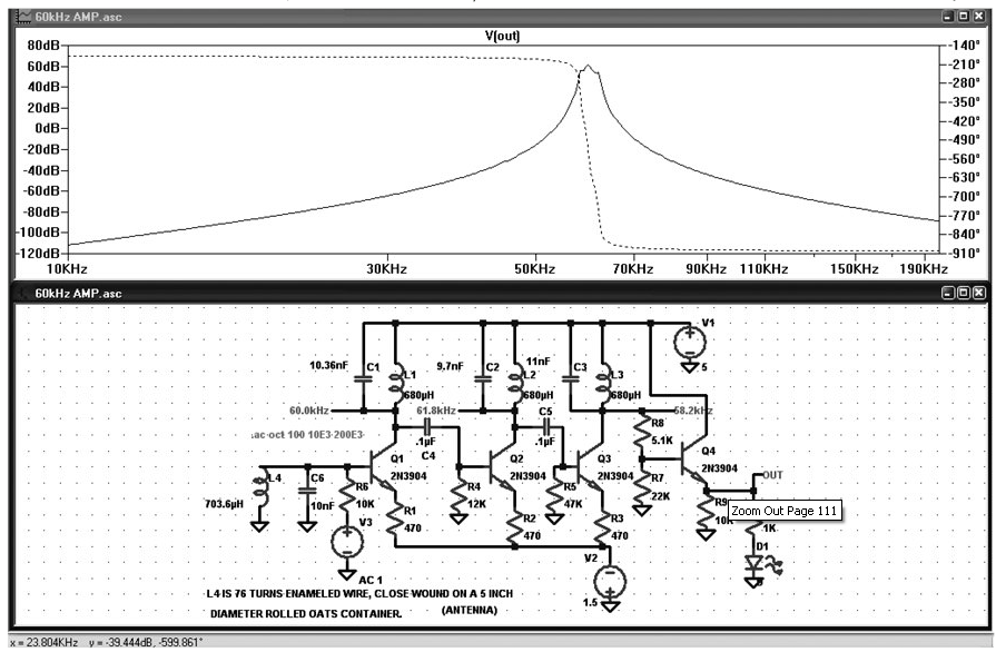

Here's a LTSPICE schematic. The circuit appeared in Nuts and Volts, May 2006 on page 111.
Now that I've entered the schematic into LTSpice, one problem I'm having is that I cannot reproduce the frequency response plot. The plot in the article shows a gain of 60 db at 60 KHz, but I'm not getting anywhere near that.
I uploaded a the schematic and response plot from the original article.

First problem I see (from left to right) is L4 is 703.6 nanofarads.
You make the 700nH inductor yourself, although you could probably use a 680nH and it'd make little difference.
He's talking about the larger 680µH inductors which can be bought from many suppliers. They only have to be low current, an ESR of 10Ω is probably acceptable. I advise buying them rather than making them because they'll be much smaller and have a higher Q.
