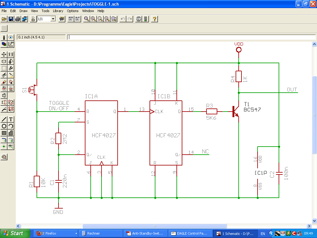

you can make any relay latch using a HCF4027 (J-K/FlipFlop).
The example shows positive triggering but you might invert it.
Both, pin14 (\Q) and pin15(Q) can be used for output.
Using a bistable (latching) relay you'll need two signals reversing when you want to switch on/off.
With the FlipFlop only one input signal is required keeping the output pins at a set state until the next input arrives.

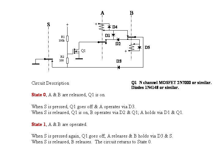

Attached is a relay Flip Flop that will do what you want.

Bonuk, is ICA & B part of the same IC? Whats IC1 P? How would you invert it to be trigged with a low pulse?
LJCox, Is A & B on the circuit two different relays? I presume the thickened lines on the switch and the FET is GND? Also, where is the ouput from the circuit (relays)?

Yes there are 2 relays. This convention is called the "attached" method. The contacts of the relay and its coil are drawn on the vertical line.
The horizontal lines connected to the switch and the source of the MOS FET are the common or gnd points.
I did not bother to show the output. All you need is a second contact on A, ie. the A relay should have DPDT contacts.
The purpose of the MOS FET is to provide a SPDT function. You could try a SPDT switch instead, but one of the relays may release during its transition period.

Dan, the IC Is a dual JK Flip Flop. IC1A is configured as a Monostable, ie. it provides a pulse when triggered by someone pressing the button.
This pulse toggles IC1B.
So it operates the same as my relay FF.
First press sets Q of IC1B High & it remains high until the button is pressed again.
IC1A
Dan,
To trigger it with a low pulse I would:-
Connect pin 5(k) to Vdd
Connect pin 4(R) to gnd
Connect R1 between pin 3 (CLK) and Vdd
Connect S1 between pin 3 (CLK) and gnd
Thus IC1A will trigger when S1 is pressed as before. It is simply a matter of using the synchronous CLK input rather than the asynchronous R input.

THis circuit needs 4 states in order to effect the state transitions. You need the second relay to provide the extra 2 states.
The relay could be operated by the button & then held by its own contact. But how do you release it when the button is pressed again?

3. The FF solution has a weakness in that the button can only be pressed briefly. Otherwise, if it is held until C1 discharges, the circuit may not work (I'd have to study the 4027 data sheet to know)
Dan,
The IC1P means IC1 pins
Dan,
I just re-read your initial post. You said the pulse is about 1 second.
So if you use the IC solution you will need to increase C1 to 1 uF. 220 nF is too small for a 1 s pulse.

With regard to the dual relay idea, I want to be able to switch up to 18A, so Im thinking to use an automotive relay? If it would be relay A that i would connect the load to, would that be the same side as the FETS's output?
To reduce cost, would it be feasable to use a lower rated relay for B? Looking at the schematic I think both of them would be switching the high current - is that correct?

With regard to the dual relay idea, I want to be able to switch up to 18A, so Im thinking to use an automotive relay? If it would be relay A that i would connect the load to, would that be the same side as the FETS's output? You can't use the contact that is connected to the FET. I'll answer this in more detail below.
To reduce cost, would it be feasable to use a lower rated relay for B? Yes Looking at the schematic I think both of them would be switching the high current - is that correct? No, The current for the logic will depend on the resistance of the relay coils you choose.
Thanks again!
You can use either relay to switch the load. It depends on whether you want the load to be switched when you press the button or when you release the button.
You need a DPDT relay for the one that switches the load.
The other one can be a SPDT.
One contact for the load and the other for the logic.
You also need to study the relay data as some relay contacts have a MINIMUM current specified in addition to the max current.

By the time the 1s pulse has ended the stage will have triggered the follow on stage already. I use that value for a light switch with multiple buttons at different locations (e.g. porch light to be switched on and off from the kitchen, the hall or living room).
Switch bouncing will probably be a problem but with a light switch this is no issue.

Boncuk,
I just had another look at your circuit.
In the conventional configuration, C1 would be connected to S so that it delays the Set.
But in your circuit, it is connected to Q/. Is this correct? Or is it a drawing error?
