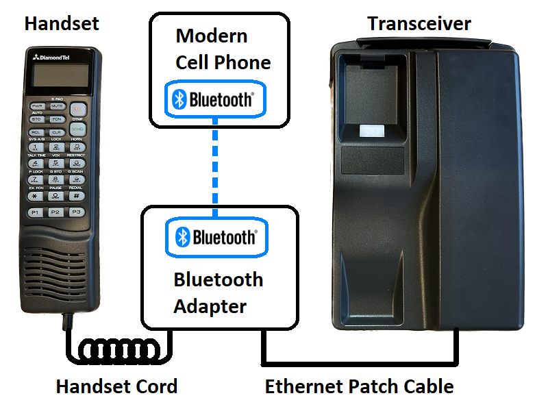

Making a Bluetooth adapter for a Car Phone from the 90's

I started playing around with KiCad, because I'm going to need to make some custom PCBs if I want to fit my electronics inside the transceiver of the original car phone (and line up the connectors with the existing holes in the case). I've decided to split my project into two separate boards:
  • Main board will go in the metal transceiver case, which is where the power supply socket and handset socket need to be. This will contain almost everything except the Bluetooth module.
    • I hope to also fit the Dayton Audio battery module in there, although I will probably need to separate the battery cell holders from the board for a lower profile.
  • A "daughter" board containing the Bluetooth module and some supporting components.
The main reason is that the Bluetooth module cannot be enclosed in the metal case. I need to put it in the attached plastic cover that makes the phone portable (has a cradle for the handset, battery charging circuitry, and a place to hold the giant 10-cell NiCad battery pack).
There's conveniently a hole in the metal lid for the transceiver case for a connector to pass through to the battery circuit in the plastic cover. I can remove all the original battery charging circuit, battery, and connectors, so that the hole is open for me to run wires through to connect the Bluetooth board to the main board. The Bluetooth daughter board will go in the large empty space in the plastic cover where the original battery would be installed normally.
Another benefit of this split is that this will allow me to easily load configuration/firmware onto the Bluetooth module by disconnecting it from the main board and connecting it to a UART USB adapter.
