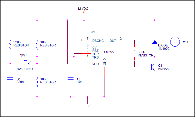

Mains Power Switch
OK, there are several ways to do this. Using your momentary PB switch for a push On and Push Again Off (Single Switch) the best way is likely using a flip flop. Several come to mind but a basic 555 will work as drawn below. For the relay I would likely go with something like this. The contacts are rated at 10 Amps AC, read the data sheet to see what suits your needs with a 12 VDC coil voltage. I would also look at a 3P3T version. That allows 3 sets of N/O and N/C contacts.
If you want an E-Stop it can be configured into the 555 pin 4 which is normally held high. Use two sets of N/O relay contacts to switch your L1 & L2. Any questions?
Ron
