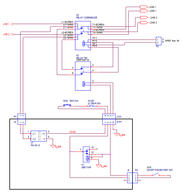

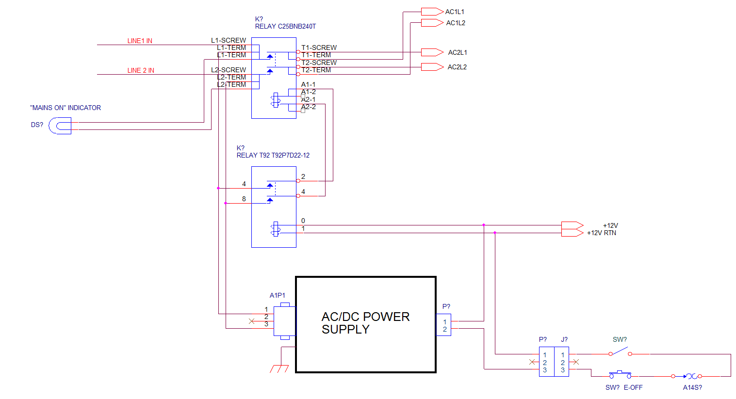

Hello,
I'm trying to design a power switch for a project. The mains input is 240VAC and I've started with a few relays, e-off, power sw, and a temp switch in the loop. I want to use a mechanical single pole push button as the main power switch, but this way with the circuit I have if the e-off switch is engaged the main sw will remain closed, so no good. Then my second choice is to use a momentary sw, maybe capacitive or piezzo, but having a little issue designing around it. I will like to see what you think or other ways of doing this with minimal components as I have little space.

Comment: your in the US, and 240, so L1 and L2 should be the lines. Designations are L1, L2, N, G. 99% of the time neutral should not be switched.
Aside: I installed one piece or 3 phase 100 Amp piece of equipment that actually had a breaker in the neutral within the equipment.
Now that KISS mentioned it, Based on the drawing with L and N you only have 120VAC.
Additionally, there are not many 240VAC lightbulbs/indicators around. I know I have looked for them, they aren't common.
Sorry for the confusion. I edited the original post.
I have already sourced out a 240VAC bulb.
There is a circuit breaker and line filter on input line, just not shown for simplicity as I'm more interested in the logic of the on/off circuit. As I mentioned I'm trying to use a momentary switch or single pole push switch to control the on/off of the main relay.

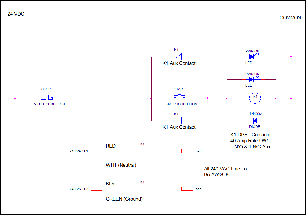

Below is a simple latching relay circuit using a start and stop pushbutton. The start PB is normally open and the stop push button is normally closed. The additional relay contacts are not shown. The LED can be replaced with a PWR ON lamp.
If something like this is what you want I'll draw it for you.

Here is how I would do it, there is no BOM (Bill of Materials) on the drawing as I have no idea who you buy parts from. The On/Off LEDs do not reflect a series resistor. Years ago I got sick and tired of buying T-1 3/4 bayonet base incandescent lamps for 24 & 28 VDC circuits. Damn lamps kept burning out in 24/7 service. Dialight and Eiko manufacture perfect replacements that don't fail. While expensive compared to the cheap lamps I love the things. Standard bayonet base so they were a direct replacement. The Start and Stop are standard PB Momentary switches. Any E-Stop(s) just run in series with the Stop switch. Since you mention 25 Amp I would use a 30 or 40 amp rated contactor with AWG 10 or AWG 8.

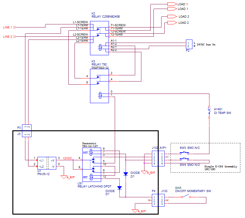

Ok guys I had some time to play a little more with this and still can't find easiest way possible to get this going. As simple as this is the only way to turn it back off is with the e-off switch or when mains power is turned off. If anyone has any other suggestions how to use the same momentary switch to turn it back let me hear it. I could always use use 2 momentary switches as mentioned before, but I want to limit it to 1.

With this one I tried using a Latching relay, but the only issue is if mains is removed they maintain previous state and once mains is restored power will come back on, ideally should remain off until SW5 is pressed again. I could also move SW3 to output of U1, but would still have same issue.
