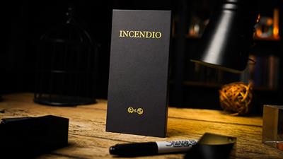

Have a look at the "TCC Incendio" - an igniter built in to a working sharpie marker pen:
The mechanism in that may be adaptable??
This is awesome, I’ve never heard of this product.
Seems like it could be adaptable.
The part I’m trying to get over is how thin a needle is. If it’s too thick it will be obvious, so I’m thinking maybe it needs a different method than heating up.
I was considering a laser inside a hollow needle but this seemed too complicated and dangerous.
