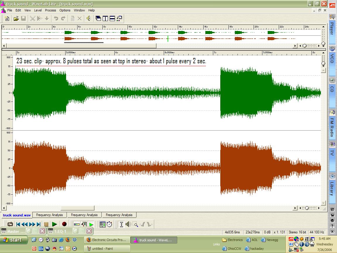

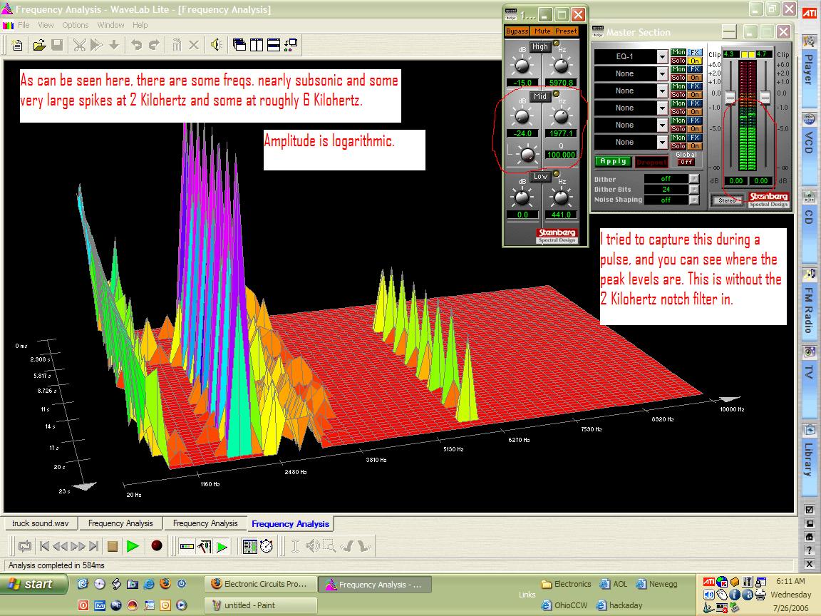

Edit: The Icecream trucks that come through here all play a nice song over a PA system for the kids!!! Ohh man...thats funny What did you record? Well even though you are joking a bandpass set at 2Khz would yield the strongest signal. It appears to be riding on a weak 16hz signal as well as some others.

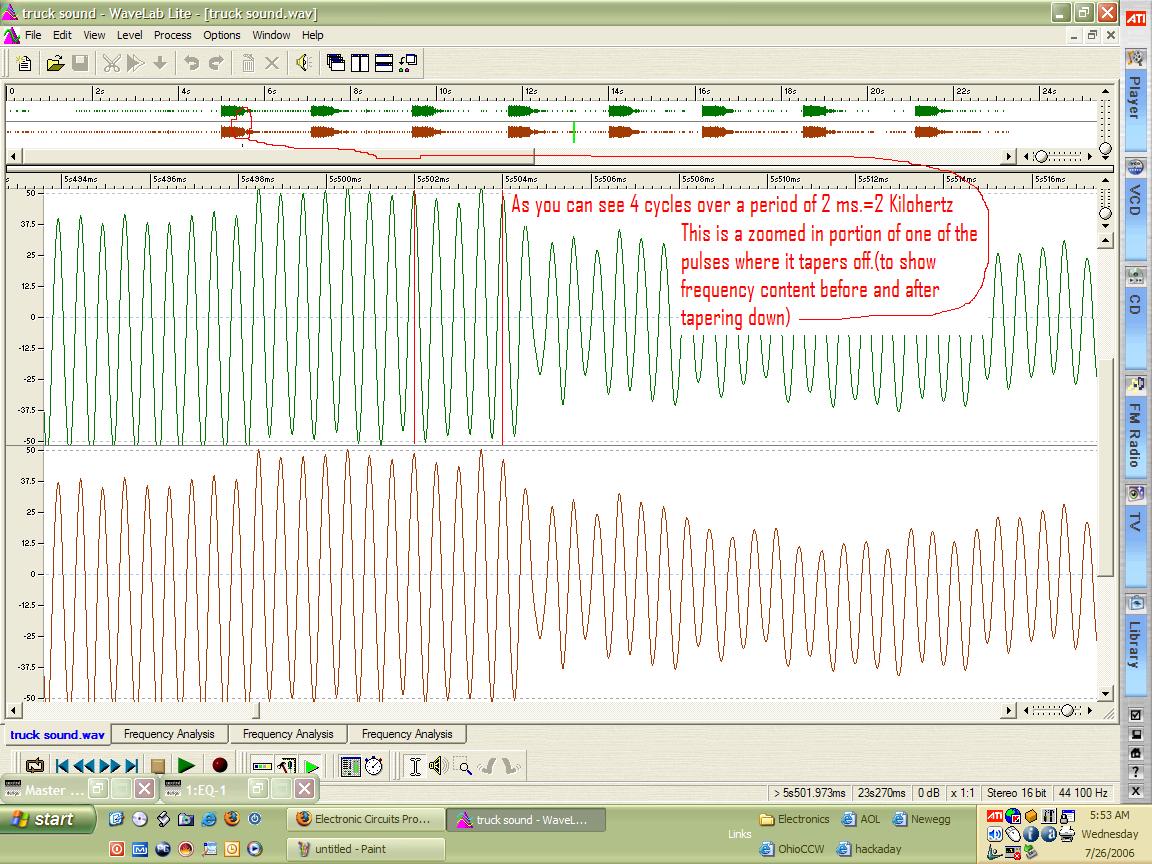

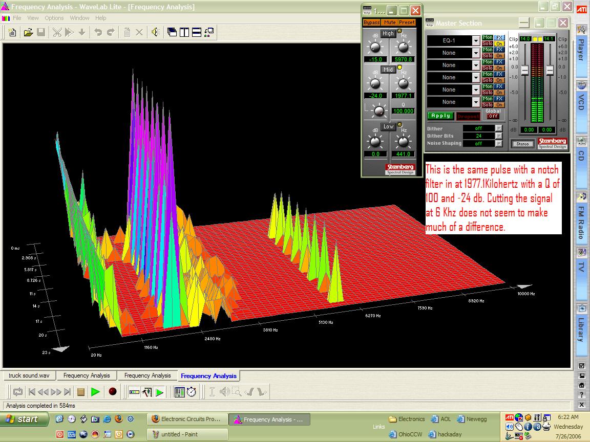

The sound luixclid posted was clearly not an Icecream truck. I'm not so sure he is appreciative of anyones time or help. Anyways here is an idea of what can be seen from this particular sound clip. Enjoy the pics.:) truck1.JPG

I have simulated a detector in SwitcherCAD III, using truck sound.wav as the input - a neat feature of SwitcherCAD III. The sound is indeed 2kHz, and I have incorporated a bandpass filter at that frequency. I would like some feedback from you guys regarding my questions (previous post) about a microphone.
