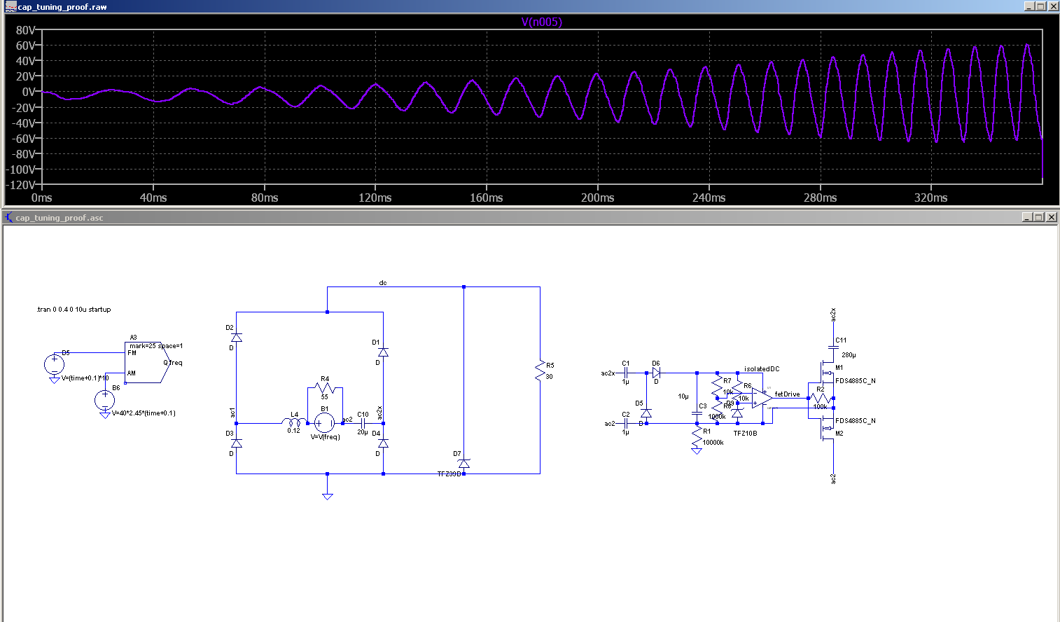

I have a 40V max AC circuit which is switching in a lot of MLCC's. At 50V these are very expensive and take up floorspace. I only need to switch them in up to 16V so I came up with the following to cut the power at a particular point then I can reduce the cost/size of these. The problem is without a resistor to ground the circuit will hang, but with it the graph is inaccurate as it's relative to ground. In other words, how to create a second ground and tell LTspice to use it for the isolated part of the circuit?
Regards, Andrew
PS) I haven't verified the op-amp yet, may have the +/- the wrong way round.
Spice is happy if you use a ridiculously high value resistor to ground, e.g 1G, to maintain virtual isolation.
I tried the circuit without R1....it didn't hang.
It might be the opamp model you are using. I used an LM393 since you didn't include the opamp model.
eT
Spice can only have one ground reference.
But you can separate the circuits with a high value resistor as Alec suggested.
In the real world there's always some finite (albeit very large) resistance between isolated points anyway, unless it's floating in space.
I made a few spurious changes and got it working.
I hadn't seen this method of creating an isolated fet driver using a pwm and capacitors - it's working well!
you could also create a node with a label named "gnd2", connect it to gnd through a 1G resistor. instead of using a ground symbol, you would use a label flag (i usually use the "bidirectional" label). that way you actually have a "floating" ground. to connect other things, similar to what you did with "ac2" and "ac2x"
