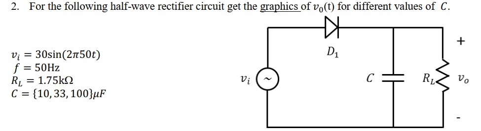

How can i put the Vi's values on LTSpice? 30sin(2pi50t)
Thanks but i want to Learn how can i do that?( Especially, pi number, dc offset, frequency etc..)
